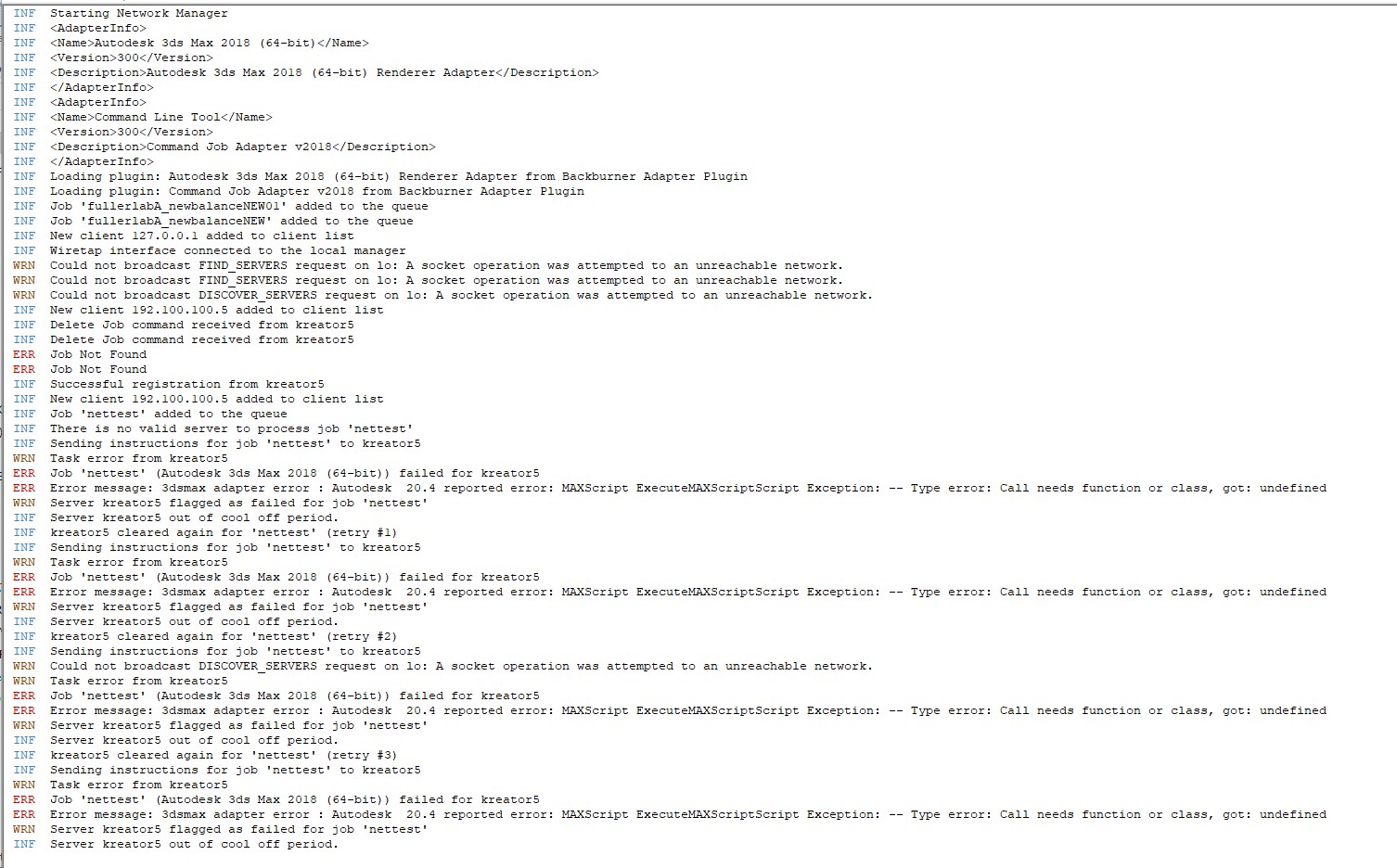

Max won't launch a network render node when using the latest Tyflow (v.1.0121)
When I revert to the previous build, the problem disappears.
I'm attaching the Backburner log and a screen shot.
Max 2018, Vray Next ( problem occurs no what the render engine), I'm sure it's a Tyflow thing.

Hmm yea I'm kind of at a loss here...
Your log shows the tyFlow sim completing without issue, prior to render completion. And the error says it's related to an ExecuteMAXScriptScript exception - but the only time tyFlow calls that function of the API in your scene is before simulation starts, and every time tyFlow calls that function it also specifies a conditional argument telling max to ignore any exceptions which may occur....so it shouldn't even be possible for tyFlow to generate an exception related to that function call.
Are you sure you don't have another script or plugin which is generating the error? I can render the scenes you've sent from the command line without issue, and nobody else has reported any similar issues.....the error doesn't seem related to tyFlow at this point...I could be wrong of course, but I can't figure out how or where tyFlow could be causing this issue.

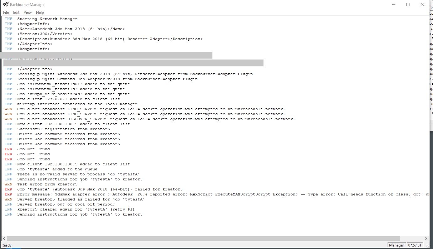

I tried all this, but no logfile seems to be generated. This is all supposed to be in the root of the c: drive, I take it.
I'll post a screenshot.
My max 2018 is not onĀ  my C drive, it's on another drive altogether.
#12
Can you open Max normally on that machine and see if a log is generated?
If no log is generated even if Max is opened normally, then there's an issue on the machine preventing the log from being created. Possible cause: your UAC settings are preventing Max from creating the file on C:\. Try running Max as Administrator and see if the file pops up. Or you can try creating the file manually (C:\tyFlowHookedScripts.log) and see if Max is at least able to fill the file once it's created.
