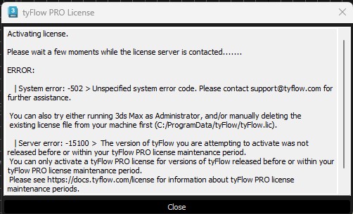

I have an error with the Pro license, I updated to 1.013 and now get this error.
my license Expired on February 7, 2023. should I renew to get the new version?
If I don't want to renew. how do downgrade to the latest version of their license(or is it not a perpetual license)?
Also, do we have to purchase a new license if the key expires after 30 days or do we only have to purchase a license renewal?
When you purchase a license it is permanently valid for any version of tyFlow released within a year of your purchase. After that point you will need to renew its maintenance to add another year of updates, and so on.
So yes, because your license expired on February 7, you will not be able to unlock the pro version for any versions of tyFlow released after February 7 (excluding v1.012 and v1.0121, which I unlocked for all pro users even if your license expired before it was released).
