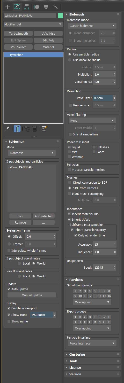

Hi all,
I scattered some tyFlow's tymesher mud splash on a road sign.
The splash dont move on the sign, they perfectly stick to it.
But when the sign moves, the blobmesh jitters a lot.
How can I fix that please?
.mp4   tymesher_jittering.mp4 (Size: 1.59 MB / Downloads: 147)
The particles are stationary on the object, but they're still moving through the static grid used to generate the blobmesh.
You'll either need to increase the grid resolution until the flickering isn't visible, or export the blobmesh as a mesh and link it to your object.
