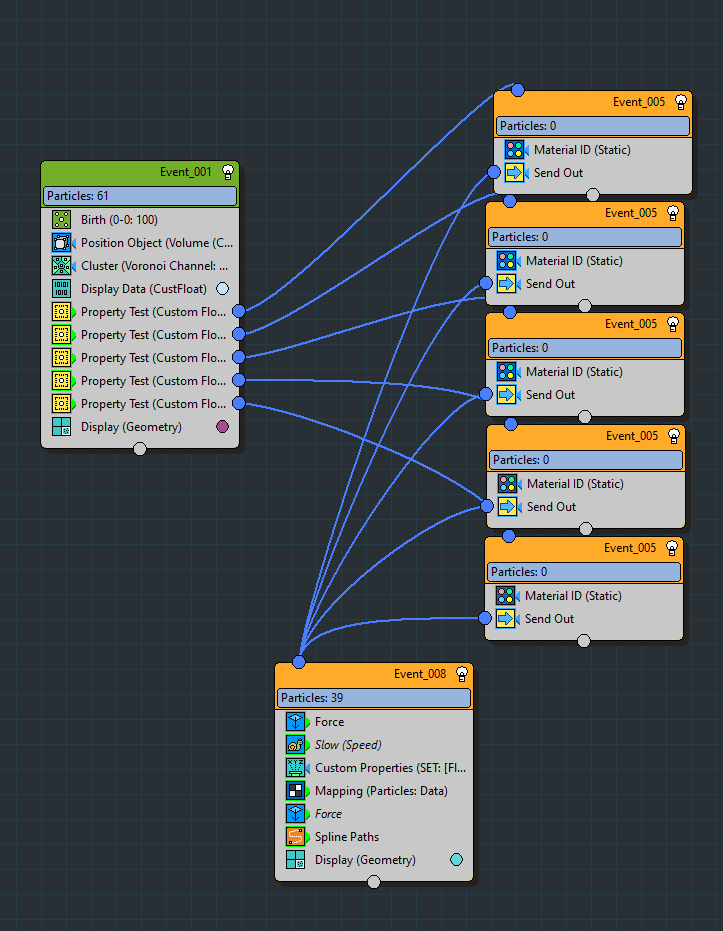

Can anyone share any quick tips on how to convert a Tyflow cluster into Material IDs....One material ID per cluster?
Seems kind of manual, but it looks like I can property test if the cluster custom float is 1,2,3,4,5...and then pipe those out to a Material ID node, then send them back into the main flow. Is there a way to do this procedurally?
You can actually directly assign material IDs with custom properties using the Custom Property operator (this function was added recently, so you’ll need a recent build).
