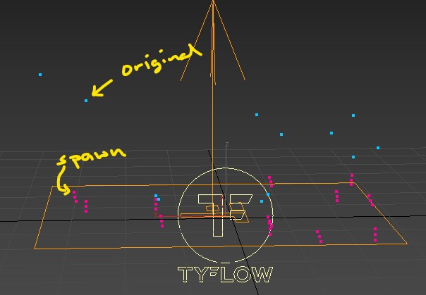

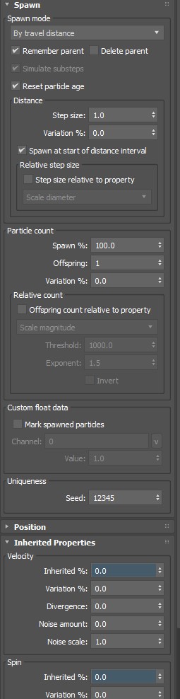

In TyFlow v1.017 in Max 2024, I'm trying to just emit a trail of particles from particles. Its the simplest of simple, but it not behaving as I would expect. The spawned particles do not continue to emit as the original particles travel.
Here is an image of the flow
And the settings
And the result -- the blue particles immediately stop emitting pink particles
I know I'm missing something really easy. I just don't know what it is.
