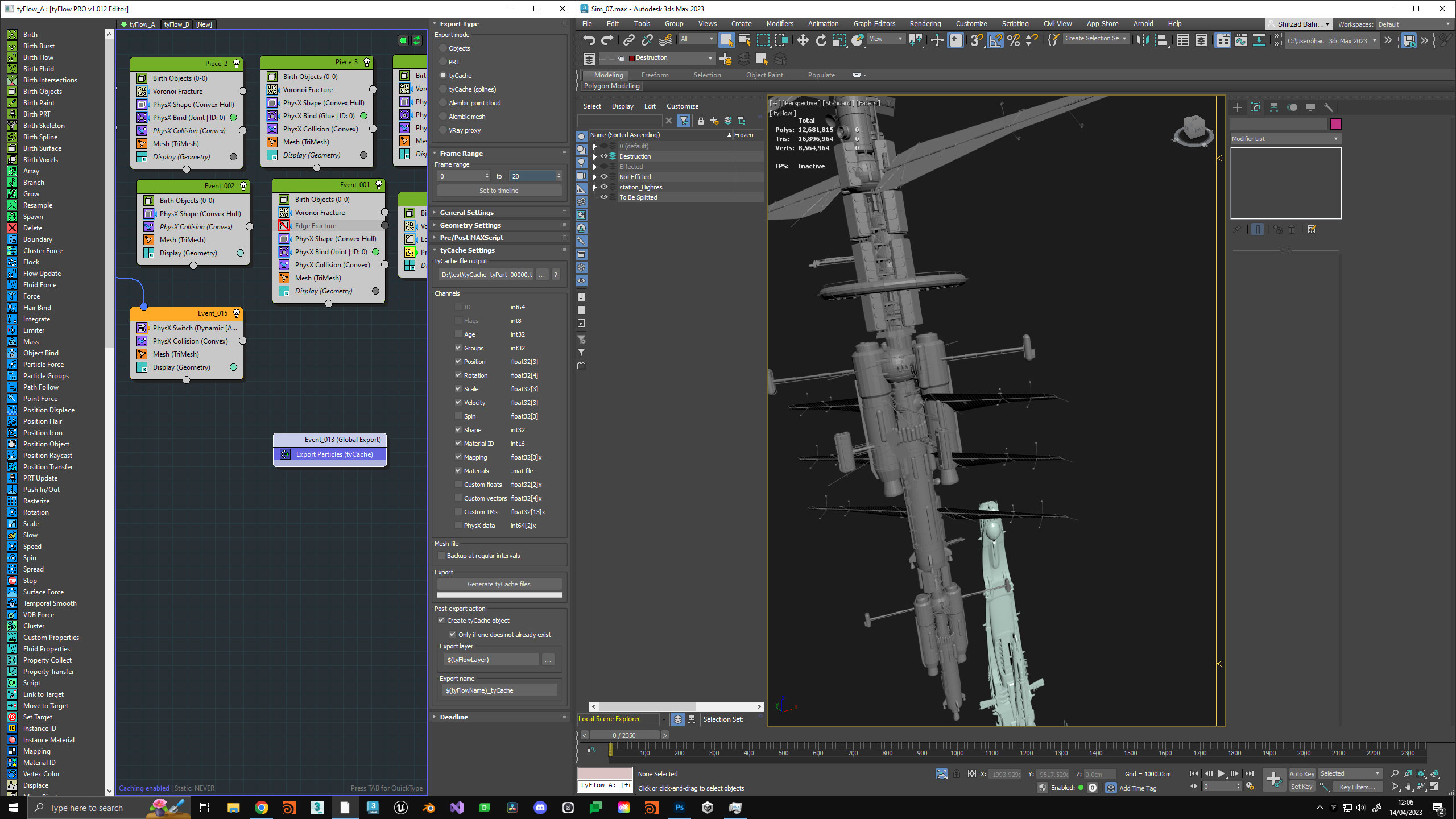

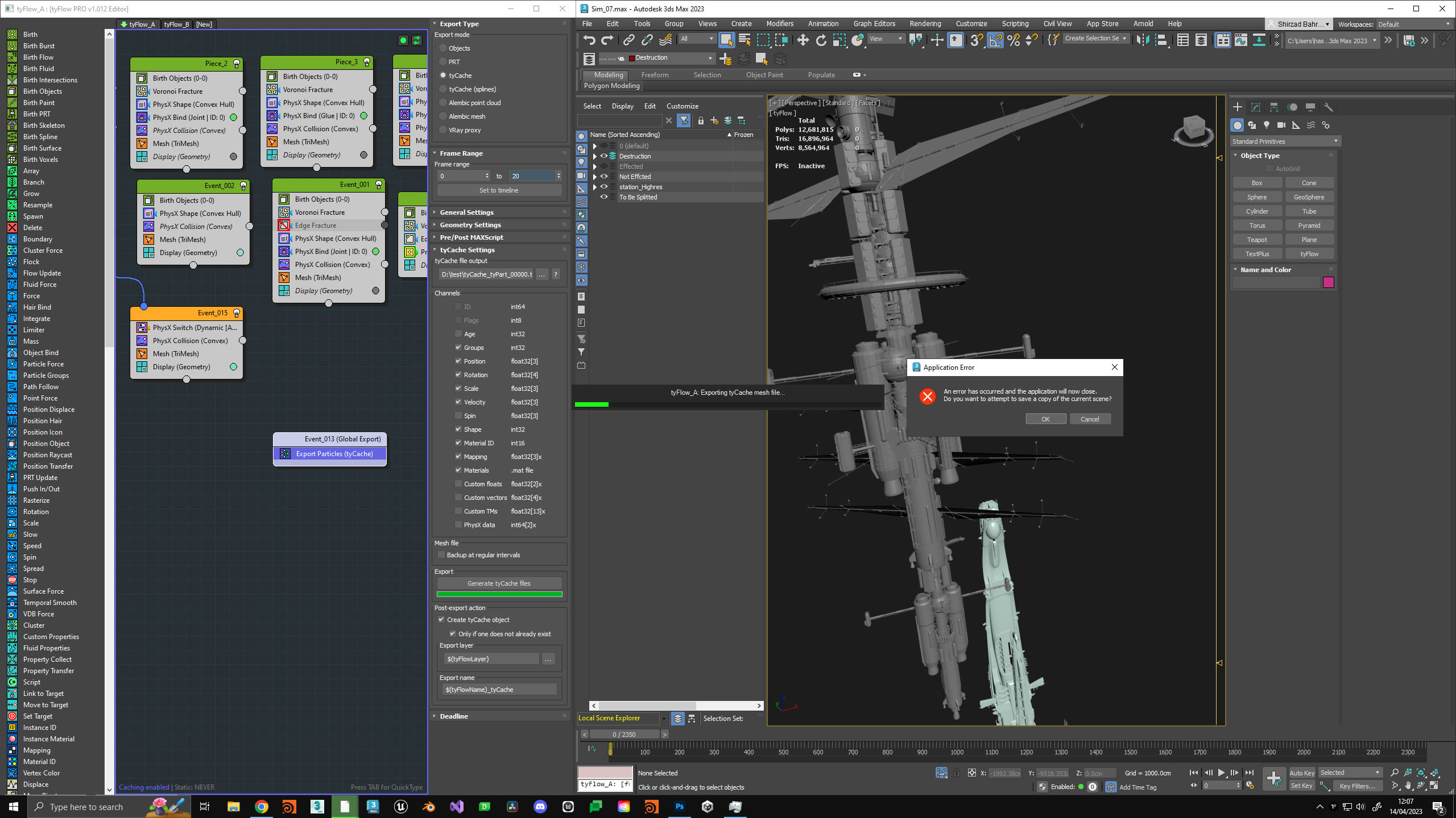

I'm working on a big simulation and I need to have the simulation as stored cache, but the problem is when the export operator reaches the export mesh part, I get application error.
Application Error When Exporting Cache
04-14-2023, 01:13 PM
Are you running out of RAM during export?
You can also send the scene to support@tyflow.com - it's possible you've run into a bug, which I will fix ASAP. Furthermore, you can send me the minidump which will give me more specific information about why you're running into an error. Info here: https://docs.tyflow.com/feedback/bugs

I noticed it's because of edge fracture operator, when I do enable that, it will crash, I'll simplify the scene and send it to you.
04-14-2023, 02:04 PM
Thanks!
