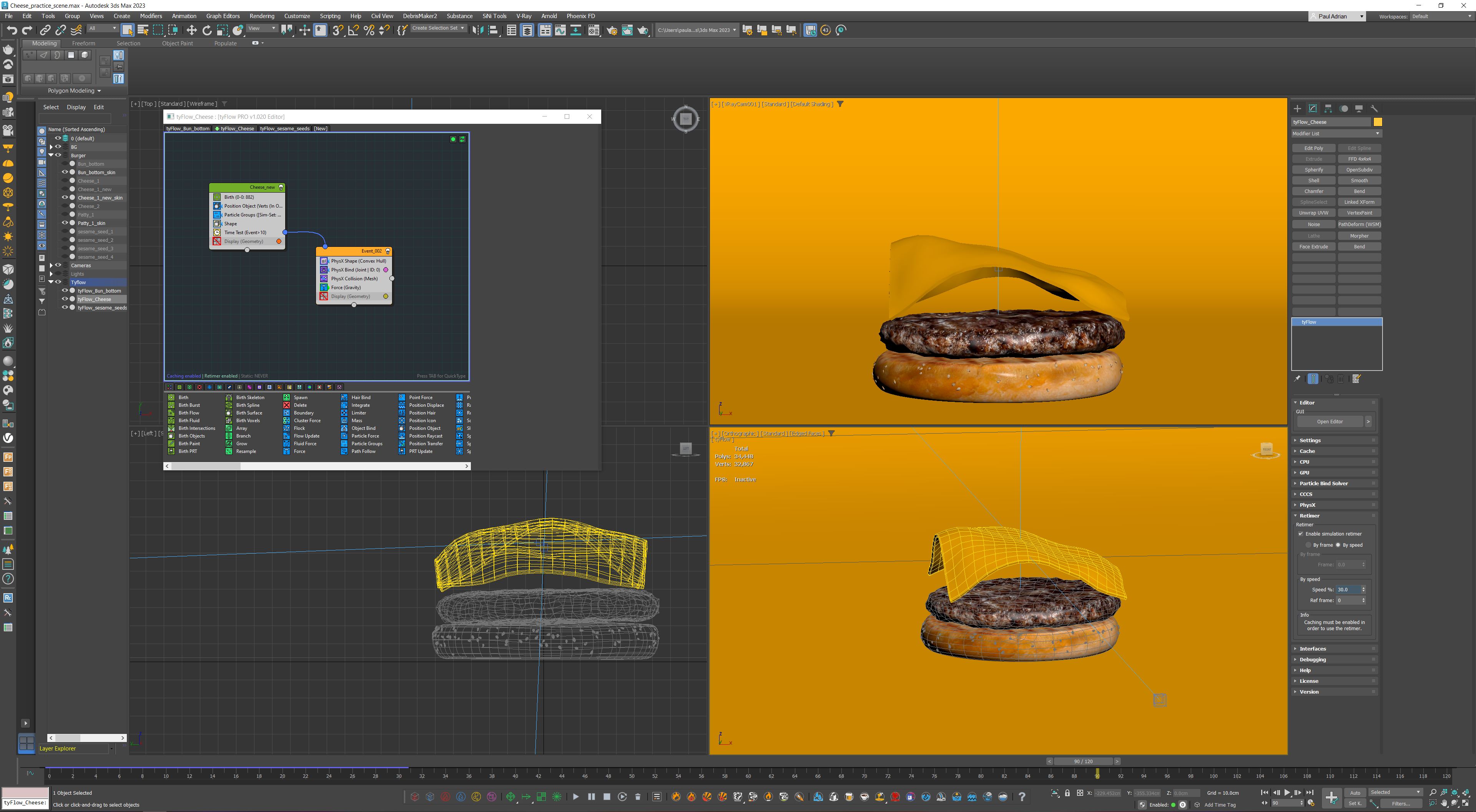

Problem: Tyflow_cheese simulation is colliding with an invisible field as shown in "retimed collision" screenshot attached BEFORE reaching the actual patty but ONLY when Retimer is used, and i need it to be enabled of course so it can match the slomo speed of the bun + patty. There's a difference in the collision behaviour when Retimer is enabled. Everything collides well without Retimer.

Well the retimer doesn't affect any colliders directly...likely what's happening is your retimer settings are at odds with the playback speed of whatever the "invisible" collider is (the collider you've added to the PhysX Collision operator). Ex: if your collider is the retimed hamburger, and you're also retiming the cheese after, the retiming is being doubled-up on the cheese relative to the hamburger.
You need to simulate everything at regular speed and then retime everything after, not sim #1, retime #1, sim #2, retime #2, etc.
(06-06-2023, 03:02 AM)tyFlow Wrote: Well the retimer doesn't affect any colliders directly...likely what's happening is your retimer settings are at odds with the playback speed of whatever the "invisible" collider is (the collider you've added to the PhysX Collision operator). Ex: if your collider is the retimed hamburger, and you're also retiming the cheese after, the retiming is being doubled-up on the cheese relative to the hamburger.
