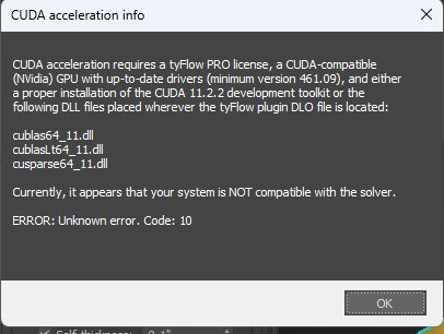

When I enable Cuda Collision Solver, I get no collisions and this error message:
Cuda acceleration requires a tyFlow PRO license, a CUDA compatible
GPU with up to date drivers (minimum version 461.09) and either a
proper installation of the cuda 11.2.2 development toolkit or the
following DLL files placed wherever the tyFlow plugin DLO file is located:
cublas64_11.dll
cublasLt64_11.dll
cuparse64_11.dll
Currently it appears that you system is NOT compatible with the solver
ERROR: Unknown error. Code: 10
I have installed the most recent cuda development toolkit, I have placed the missing dll files in the plugin folder.
I have updated my GPU drivers.
I have purchased a tyFlow Pro license, which is activated (node-locked)
System information:
Windows 11 Pro
Two GPUs: Nvidia RTX 4090s
Any help would be very much appreciated.

 Thank you for your help.  I copied the DLL files to the max root, that seems to have fixed the issue.
Cool, yea there's an order that Max/Windows will search for DLLs that can sometimes create issues if you have alternative (incompatible) versions installed.
I think it's something like...Max root first, then System32, then PATHs, then it defers to me which is when I tell it to search where tyFlow is installed...if it finds a version it thinks is ok at any point in that search, it'll use it - which is what creates the problem if it finds the wrong version first.
