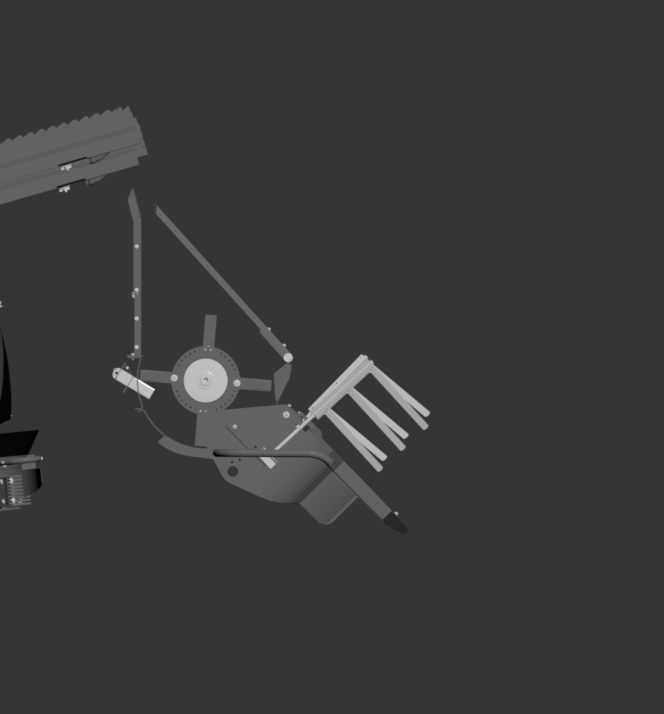

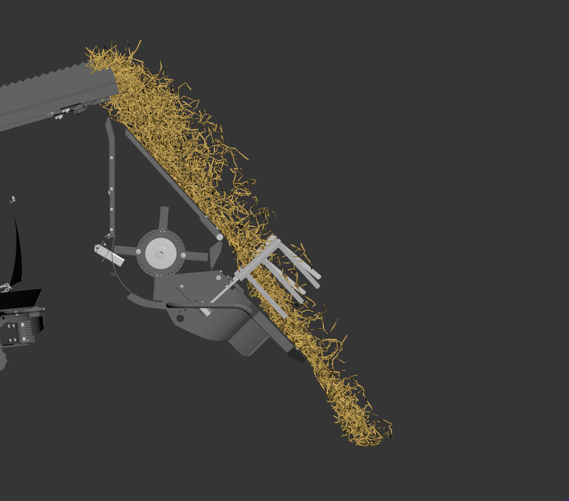

I have a system with ClothBind for straw in an agricultural machine.
The reference objects are quite simple sticks that just fall above some deflectors.

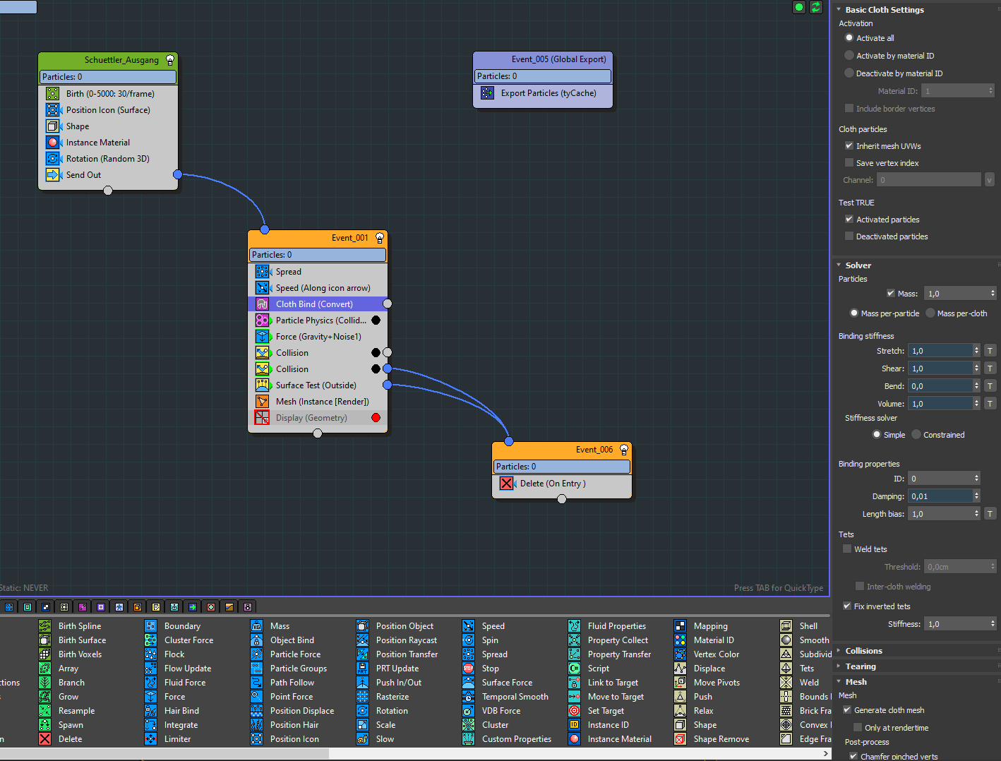

Now my problem starts when I want to cache those.

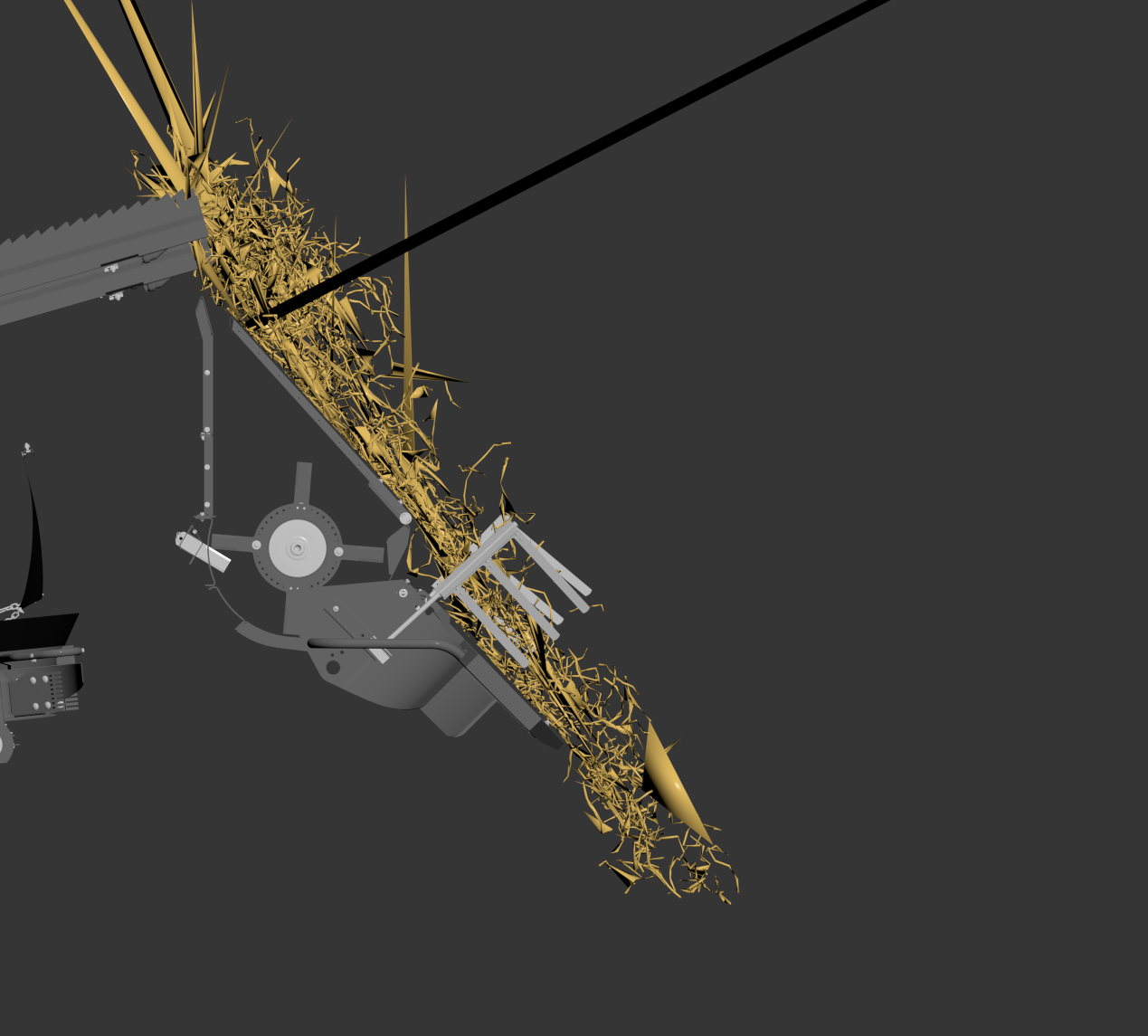

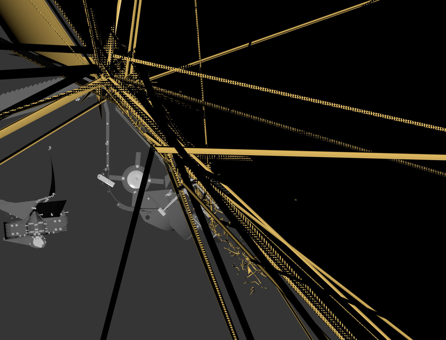

It works completely fine for a while but eventually after 1000-2000 Frames it starts producing artifacts that gets bigger and bigger and then the system vanishes completely.
Is it maybe a memory issue? How can I fix this to cache till the end of my animation?

In this file when I hit the Generate Cash File button, the errors begin around Frame 400 and quickly get worse until complete chaos.

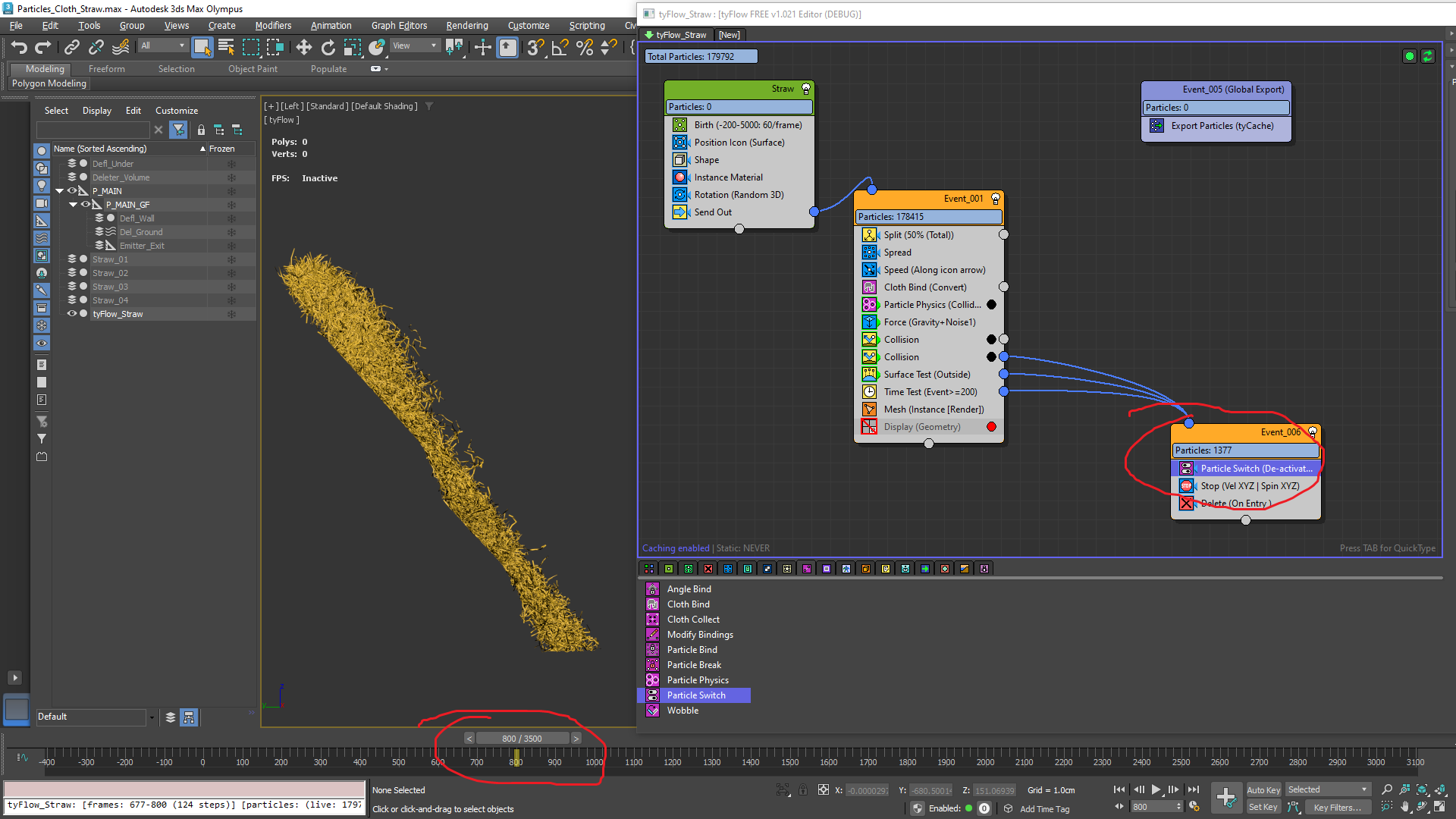

One thing I did notice is that if you disable all of the operators that are sending the particles to the Delete event, the bug doesn't seem to occur any more (at least, it didn't occur up until frame 500 - I didn't simulate further with them off)....so it might be related to the deletion of your cloth particles. Furthermore, I tried deactivating/stopping the particles before deleting them, and then I couldn't repro the bug even until frame 800....so maybe that's something to explore as a workaround (add a Particle Switch (deactivate mode) and a Stop operator to Event_006 before the Delete operator).

Thanks for the reply, I am gonna try your workarounds and see if that helps.
