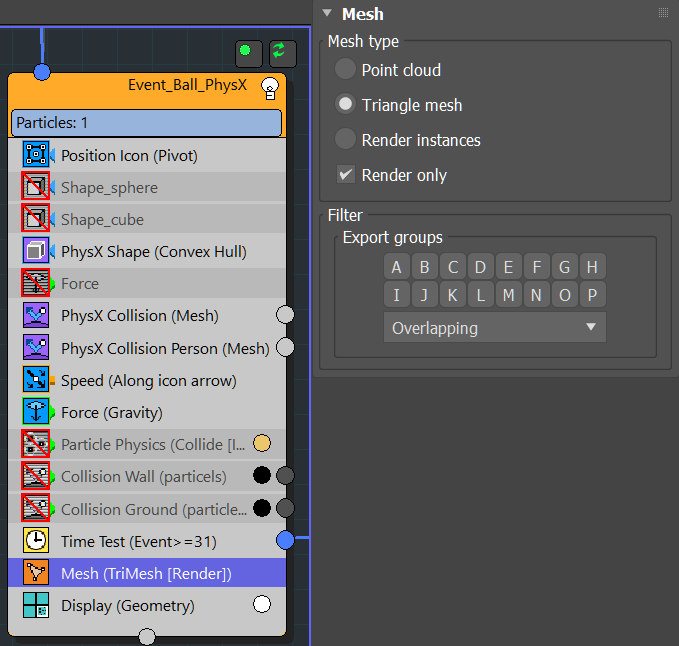

Hello,
in Particle Simulations often "relax" and "turbosmooth" were used.
When I do the same with PhysX my objects disappear in the viewport.
Did I miss something or are these modifiers limited to ony partcles?
Did you add a Mesh operator?
(07-16-2023, 02:32 PM)tyFlow Wrote: Did you add a Mesh operator?
yes of course
This is the simplified Setup attached
.max   PhysX and Modifier Tyflow.max (Size: 636 KB / Downloads: 193)
Yea but it’s set to render only…
(07-16-2023, 04:43 PM)tyFlow Wrote: Yea but it’s set to render only…
Great thanks! Smile
(Just wondering why render only is the default, but now I know it's meaning.)
Render-only is default to avoid lag/crashing/etc in situations where you're rendering huge numbers of particles as instances.

Thanks, I got it!
Maybe good if there would be a note: "Turn off if you need to see PhysX". The correlation to PhysX or Particles seemed not obvious to me.
