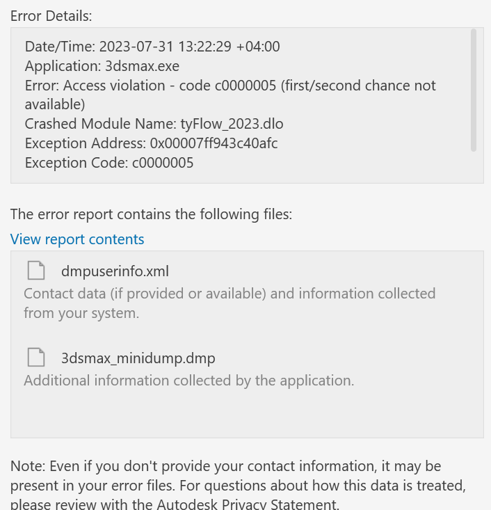

3ds Max version 2023-24 crashes as soon as it loads the tyflow plugin, while still loading Max.

Same problem here, I'm using 3dsmax2024   26.0 - 26.0.0.940 and it crashes at loading.
I simply pasted the tyflow_2024.dlo file into my 3dsmax 2024 plugins folder.
I tried with 2023 version and it crashes as well
Any solution?

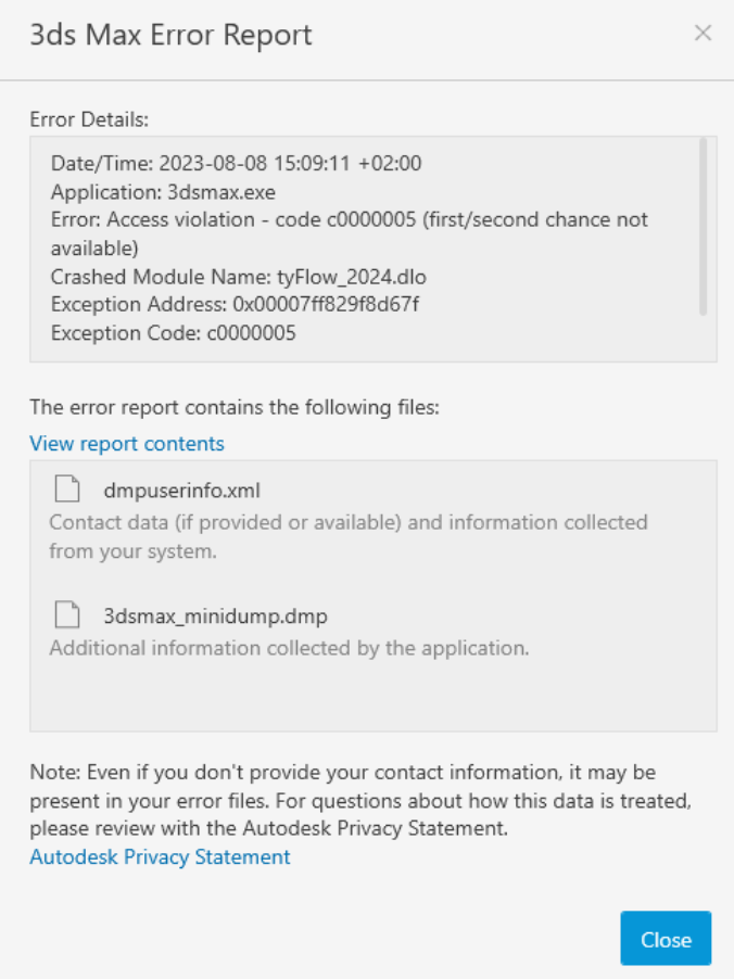

hi tyson,
same here. all was working and after a computer crash max wont start with tyflow anymore.
if i delete the dlo max starts fine again.
downgrade also do not fix the problem...
any idea?

hi tyson,
the error is still there...
any idea now?
bye
jens
okay after deleting the lic folder in the programdata folder it is working now, i thought that if we uses a floating lic it is not present.
