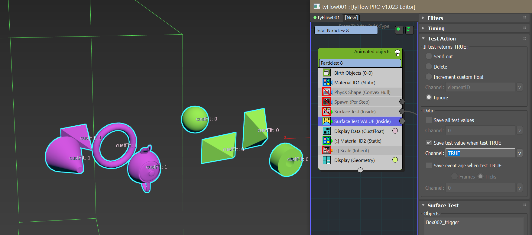

The situation is that many animated objects were spawned by a surface test.
As the object is spawned only once at the first frame, it can't has to do with the jitter in the later frames.

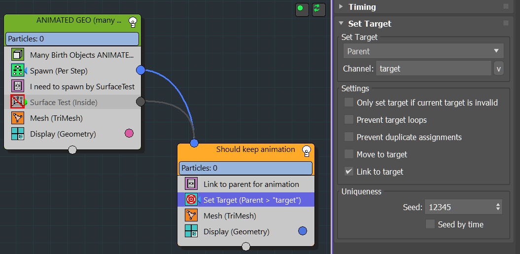

I have those tasks which I can't solve right now:
1.)
- Objects should collide (PhysX), and go into a new event, but keep their animation.
The only way to keep animation I found until now is to spawn and link children to their parent.
2.)
- They should be spawned (once) with a surface test. I have still no idea how that is possible, while keeping their parents in place.
3.)
- As soon as the child have been spawned, the parent should become invisible (by material) and deactivated by physX.
I only need them to read out their animation. So I can't delete the parent and it must stay in that event (afar as I have tested it).
I also tried to solve it with custom properties, but did not succeed.
2) and 3) are the more important things, for the first I can find a workaround.

Maybe I have a solution for changes within the same event:
Surface Test not with send out, instead with defining a custom float!
Have never examined this before.

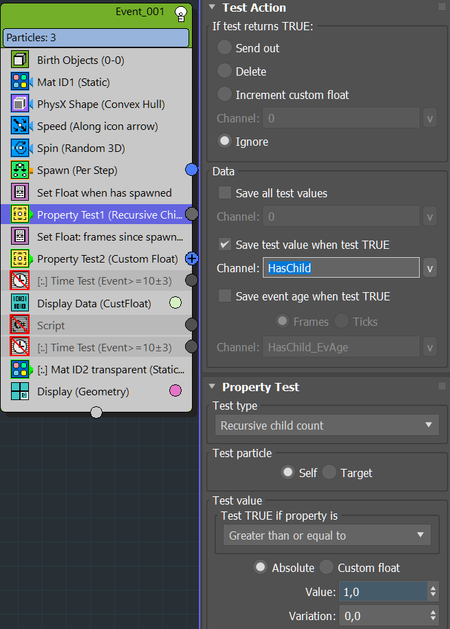

I've tested further:
- I have set a float, which changes the material after spawn (in order to make them invisible).
Attached a new file!  (v1.024)
And got new question Wink

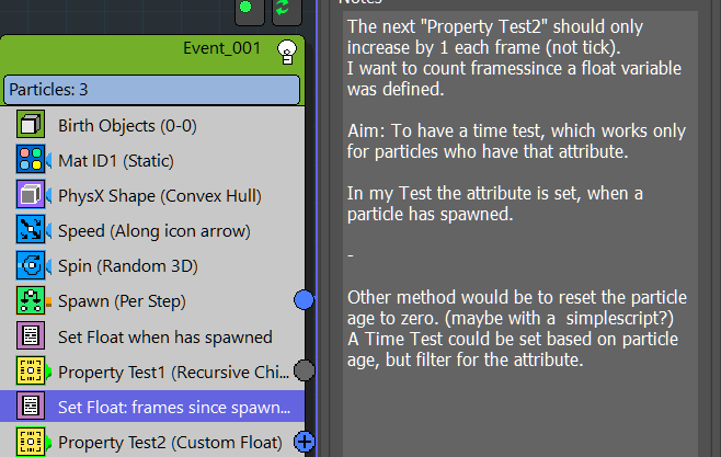

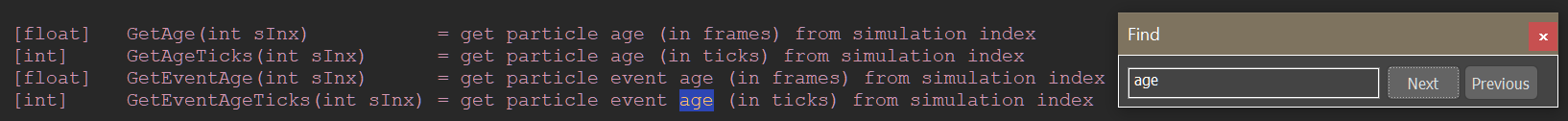

- Is it possible to reset the Particle Age within the same event? (I know it's possible to restart when it enters a new event)
I have searched also in the Script operator, but did not find "SetParticleAge..."
(never worked with "Script" before, but think I should look into it)
or

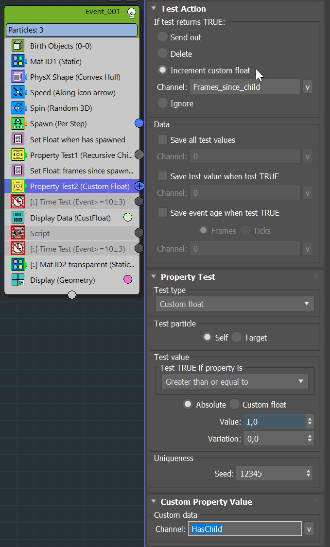

- Is it possible to increase a float not by ticks but by frames?
When I check increase, it is increasing based on ticks. So when I would change the Simulation step size, it would alter the value.
My aim is to build a "time test", which counts since the frame when an attribute has been defined.
(reason: this would come handy in some tricky situations when I want to keep particles within one event but treat differently)
