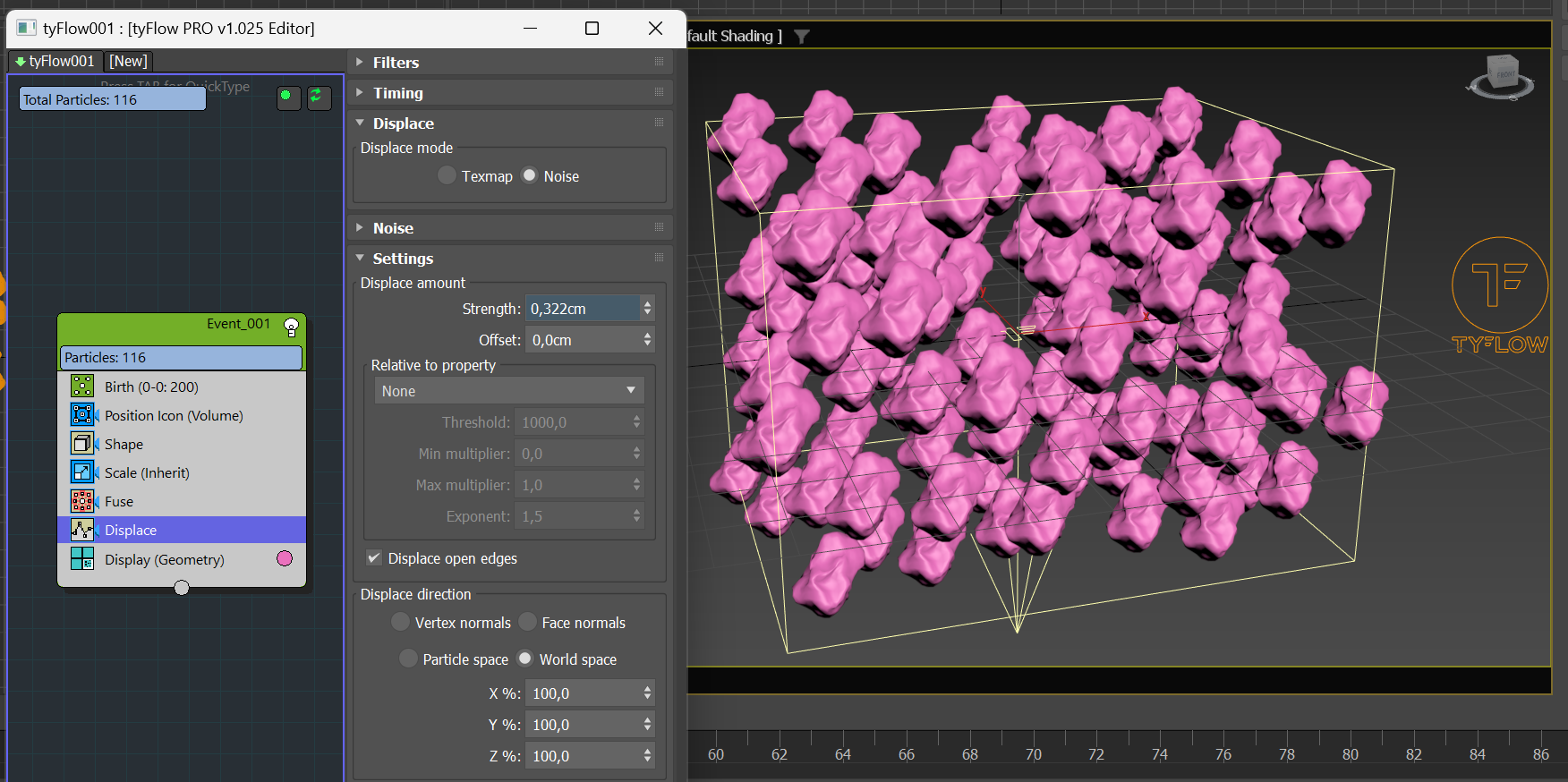

Problem with Displace operator in World Space
Up to version 1.0055 the displace operator when used through Noise in displace mode, delivered an individual displace for each particle if the displace direction was in World Space, but after updates to TyFlow's noise system, even in world space, the noise displace is the same in all particles, I made a video to exemplify, would you be able to fix this?

Thanks for bringing this to my attention...I wasn't aware of the behavior difference that occurs there when the new noise was introduced. I'll get that fixed.
