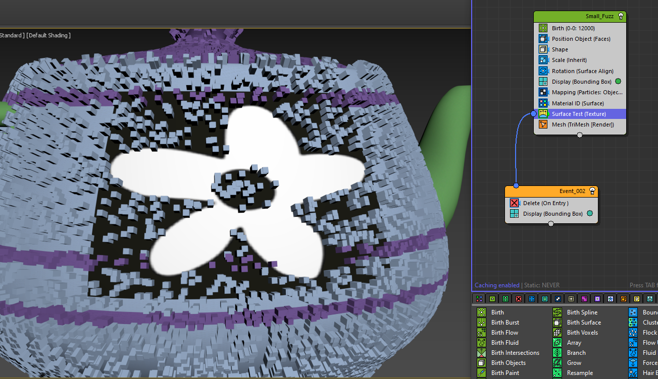

This is the setup as you described right?
Yep looks good…you can also just change the test result of the Surface Test operator to “delete” so you don’t need the extra event.
