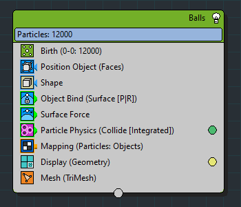

Thanks for the quick reply Tyson, there's no topology change I'm aware of; all particles are birthed at frame 0, shapes are static Geospheres and the count remains the same throughout. I've attached a screengrab of the flow, kudos to AestheticVFX and FXManiac for their original tutorials to set up this effect.
