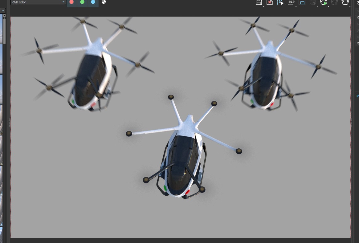

Got an issue with an Animated (Grouped) shape.
Motion blur from the tyflows motion(speed) is just fine.
However the animation in the grouped object is missing.
The object in question is a drone with spinning propellers.
Propellers have no motion blur.
Attached an image detailing this issue:
2 drones on top are tyflow instances
1 drone at the bottom is object.
You can see the motion blur on the objects propellers is working as expected.
But not with tyflows, and just to make sure motion blur was working I added some speed to them, so you can see that tyflow is calculating some motion blur.
Tried a lot of different variations of settings including the following:
Time step 1/4 1/6 etc
Vray instance on / off (same with meshing node)
Speed variations in shapes animation
Not sure where to go from here
