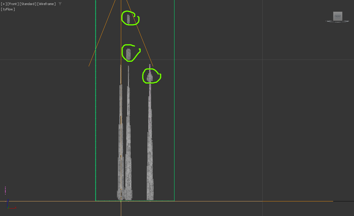

I have a Phoenix Source using tyFlow particles for emission. The Source is set to use the Particle age and is using custom particle size, which is animated to go to 0 over 10 frames.
The emission works correctly just before it reaches frame 10.
I suspect that something goes wrong with the last keyframe when using the particle age.
If I use absolute age of the particles - everything is fine - if I use pFlow with the same setup it also works correctly.
In the atttached screenshot - the green areas are the problematic ones. The left smoke spike is using pFlow and works as expected - the middle and the right one are using tyFlow.
Maybe there is something wrong with the Particle age - but I couldn't figure out what the issue is.
