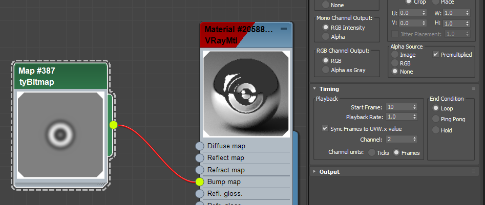

A tybitmap set to 'Sync Frames to UVW' does not work for bump map and normal map.
Material preview displays correctly but does not affect in rendering results.
It works correctly for other maps such as diffuse, reflection and so on.
And if 'Sync Frames to UVW' is unchecked, it works on bump map.(However, animation synchronization is not possible.)
