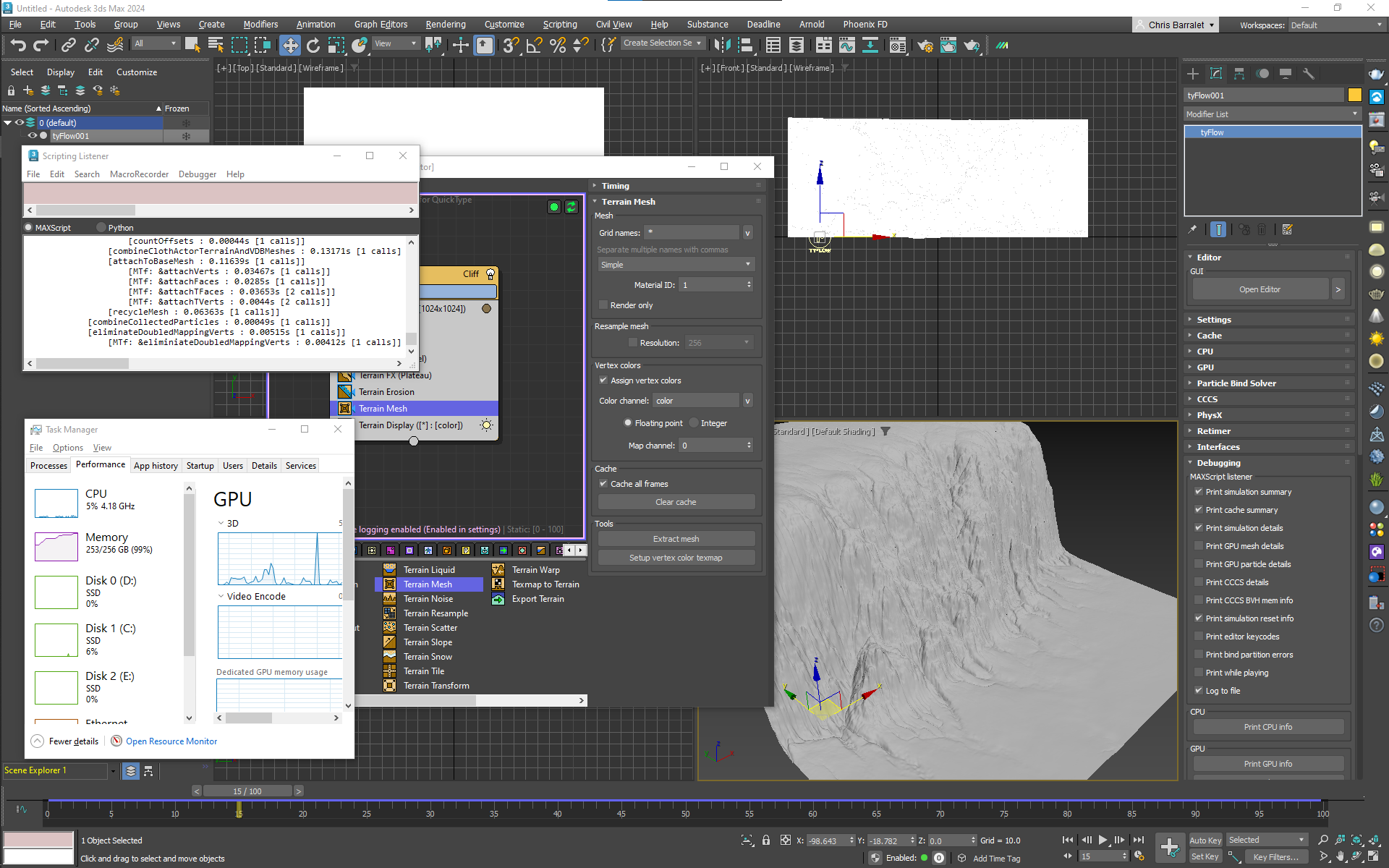

I've attached a screen grab (probably not that helpfull), but it doesn't require a terrain colour operator as i originally thought.
Here's the debug from the listener:

Ok some further investigating:
The bare minimum for this to occur=
*birth terrain
*terrain mesh
a ty terrain colour map in a material (it doesn't matter what type) linked to a tyflow. The material doesn't have to be assigned to an object, it can sit in the editor.
It seems to me that something is being evaluated every frame and the ram just keeps geting eaten up. Even advancing 1 frame is sluggish.......
***update***
closing the material editor stops this behaviour, so very wierd.
[attachment=3190][attachment=3190]
.max   ram_eating_monster.max (Size: 812 KB / Downloads: 207)
Ok great...the material editor being open was the key. I can now repro the issue and will work on getting it fixed. Thanks!
(12-12-2023, 02:04 PM)tyFlow Wrote: Ok great...the material editor being open was the key. I can now repro the issue and will work on getting it fixed. Thanks!
cool.
