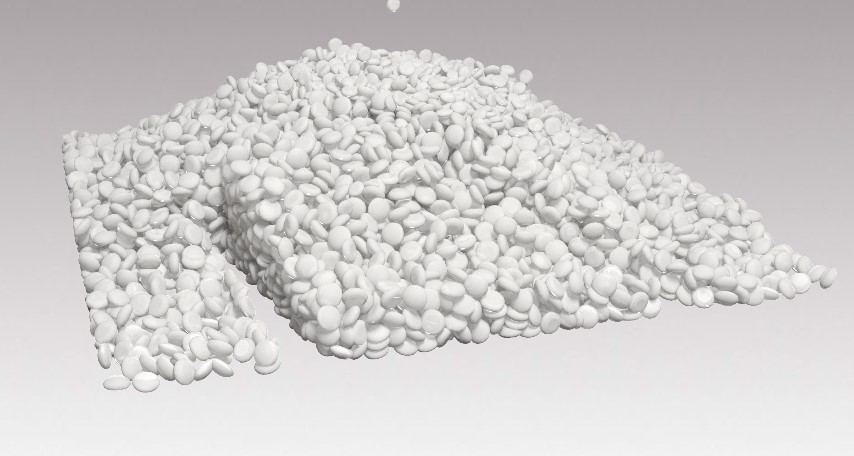

short back to this topic: yes, I am having geometry. So I exported as alembic. Connected *.abc to "Alembic Object" in Max.
Works well with one exception, that assigned Material is somehow differently interpreted and is not looking as expected.
The screenshot shows static objects of baked edit polygons. And the strange transparent /chrome-looking drops are the alembic obj.
Sharing the same material.
Where´s the trick?
Try importing your ABC with a VRayProxy object, if possible. It properly assigns material IDs whereas that functionality does not work in vanilla Max.

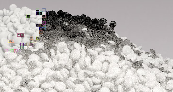

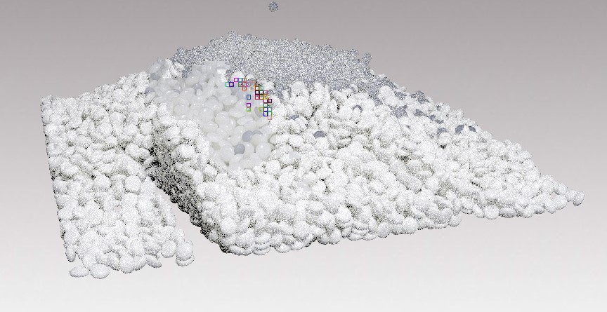

...trying to do it with tyCache. How do I avoid the following issue to me:
The Polygonblock and the TyCache node are assigned once with a VrayMaterial and another one with a FastSSSMat.
Both are sharing, that the light cache give a very different appearance compared to the Polyshell underneath.
Only when the final rendering goes along, the VrayMat make finally no difference. The FastSSS still gives in final rendering
a darker appearance. What´s the deal with that?
normal VrayMat. strange LC
...but rendering is fine:
FastSSS: strange LC also here, but rendering does somehow cover what probably went wrong
(like the few greyish ones in front of where the picture has been already finaliced.
