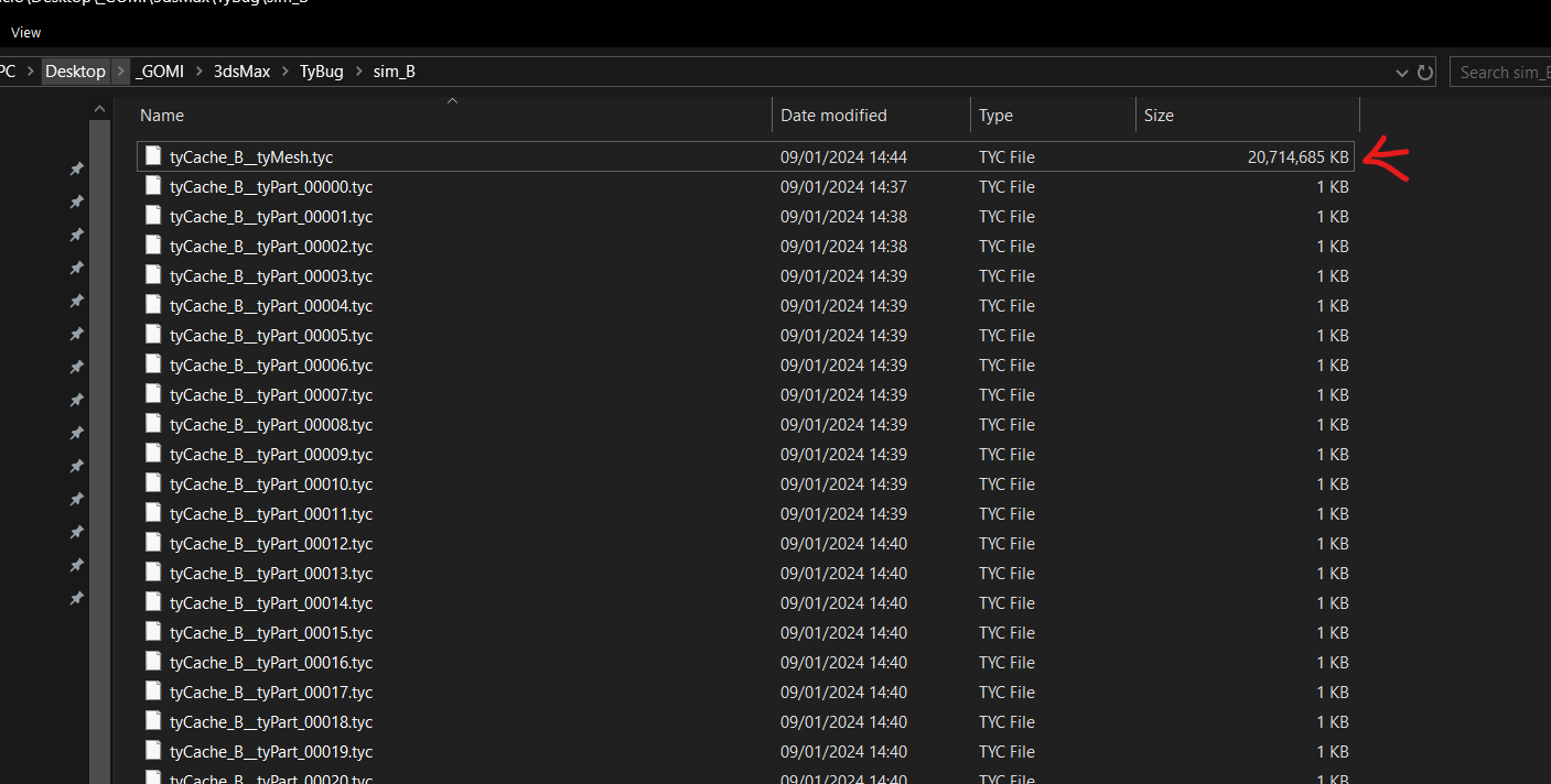

so I think...
It is because in the seccond tycache or tyflow, to be able to load the first tycache it puts it all in 1 file.
TyMesh of 20GB
then for each instance of this animation offseted it just duplicates this 20GB again and again instead of just loading the frame it will render.
Correct?
maybe I should plan that differently... scatter just points with the 2nd tyflow... and then find a way to replace those with Individual TyCaches ( with keep in ram off ) then possibly will be loading just the specific frame for each tycache offset and not all the sequence like now.
maybe?
