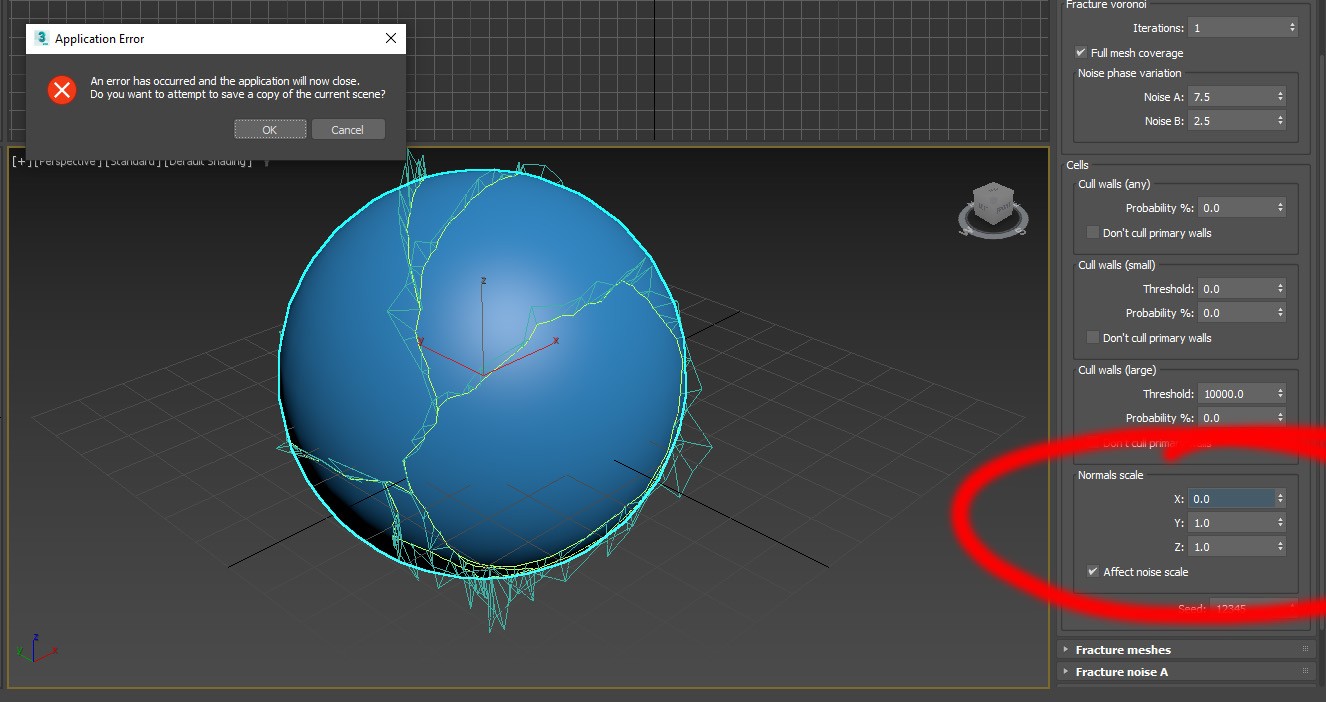

Crash with multifracture when altering normals scale
I guess going down to Zero accidentally did this?
Crash when altering normal scale on multifracture (does the same inside a flow too)
Ah thanks for letting me know...looks like I forgot to clamp minimum values there, so a division by zero is happening. Will get that fixed for the next build.
(01-28-2024, 05:13 PM)tyFlow Wrote: Ah thanks for letting me know...looks like I forgot to clamp minimum values there, so a division by zero is happening. Will get that fixed for the next build.
No problem!
