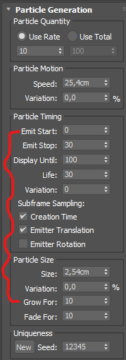

I'm missing one thing from standard Max particles (pflow), the ability to scale-in particles from birth, from fx. 0-100% over 30 frames.
How is this done in Tyflow?

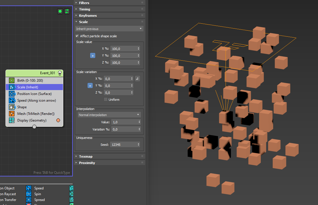

Ok, I sensed that the solution was in that direction. I'm just too much of a Tyflow novice to figure out which combination of settings to choose to get what I want.
An very basic example scene would be wonderful to have   Confused
Do you want to scale with keyframes? Or procedurally?
(01-30-2024, 03:25 PM)tyFlow Wrote: Do you want to scale with keyframes? Or procedurally?
Hmm, in 3DS Max it's built into the flow presets like blizzard and super spray, so it's linked to emit start frame. I have inserted a scale operator into the stack and played with the various settings, without luck.
I guess I want procedurally, this scale up/down should follow the birth frame.
/Thomas
For procedural scaling, you can use the interpolation parameters of the Scale operator.
In this scene I start by scaling particles to zero in one Scale operator on their birth frame, then in a second Scale operator I scale them up to 500% over 20 frames using the interpolation parameters (timing in this operator is set to continuous). Finally using a time test I send them to another event after 50 frames and scale them down using the same interpolation settings.
