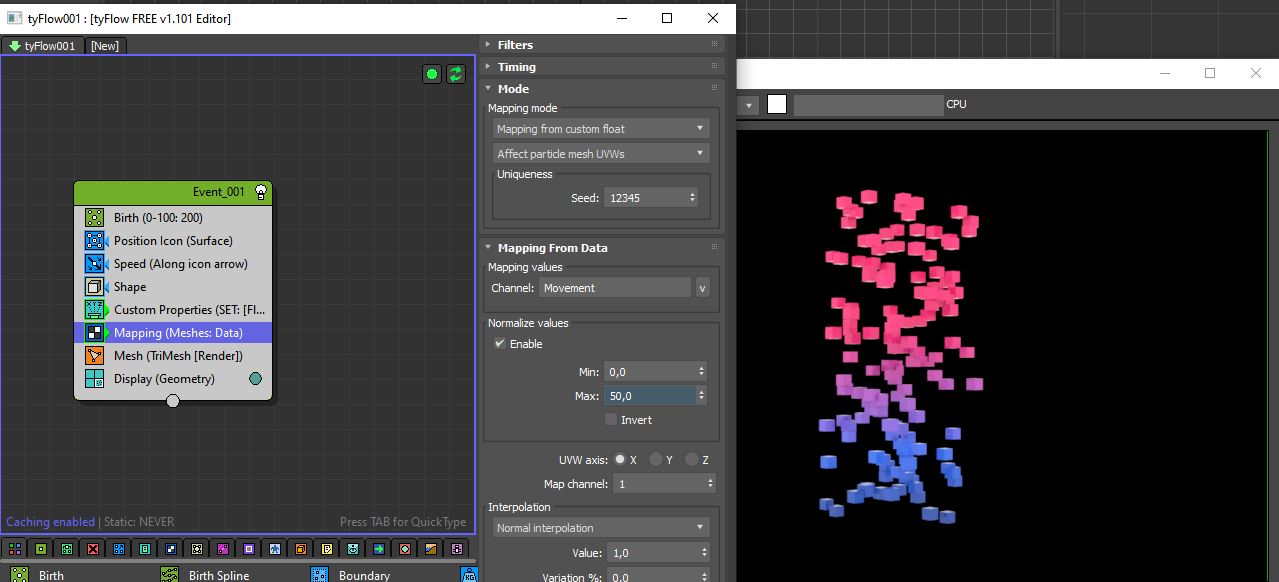

Playing around with coloring particles according to their position.
Works fine and looks fine in viewport.
But when I render (using Arnold) the gradient is on each particle, not the flow.
How do I fix that?

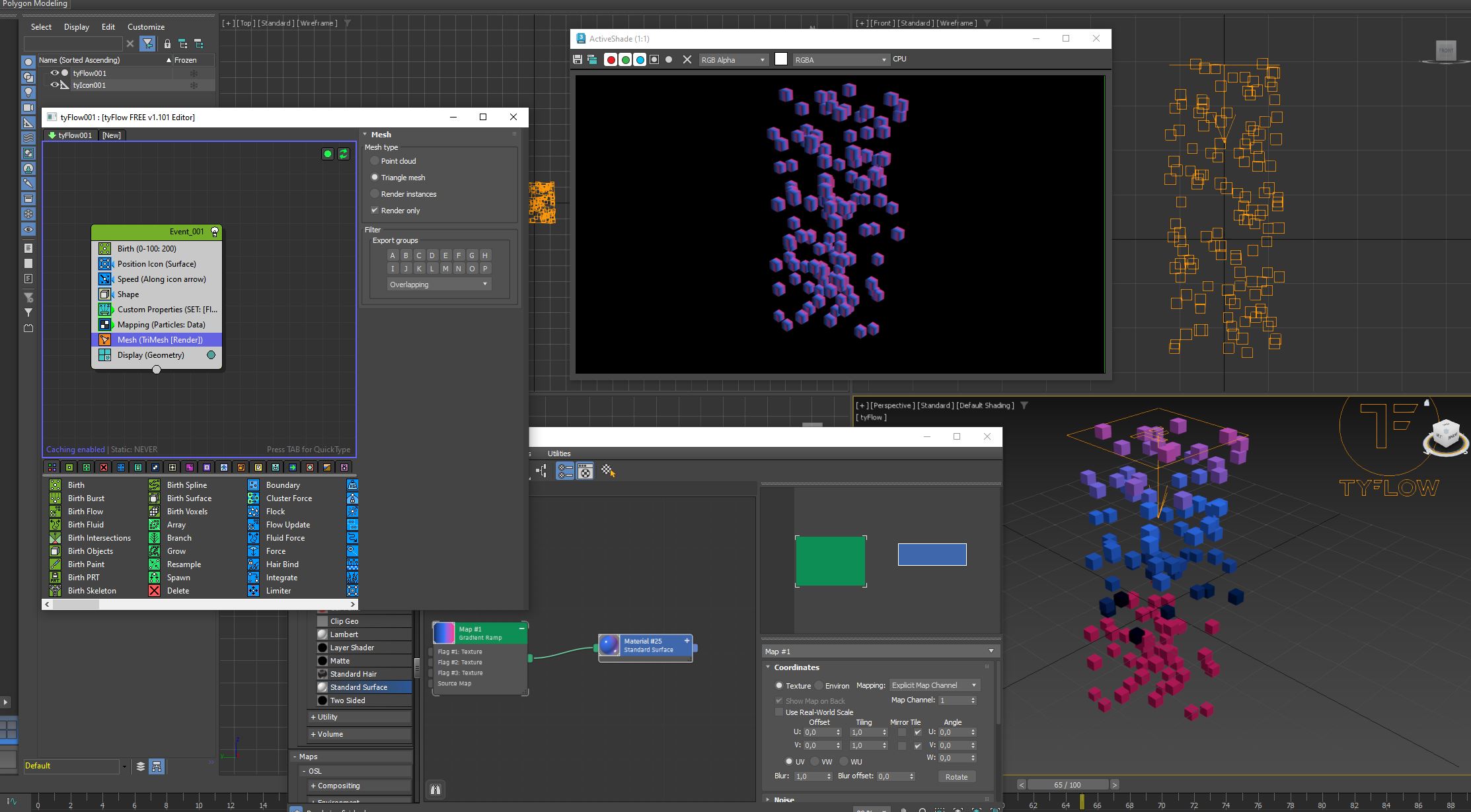

Hmm that's odd...do you get the same result with other renderers? (ex: Scanline).
(02-09-2024, 01:52 PM)tyFlow Wrote: Hmm that's odd...do you get the same result with other renderers? (ex: Scanline).
Hmmm, must be a Arnold render setting?
Quicksilver renders it fine.
I will try do find a solution.
Thank you.
Works when mapping mode is changed to "Affect particle mesh UVWs".
