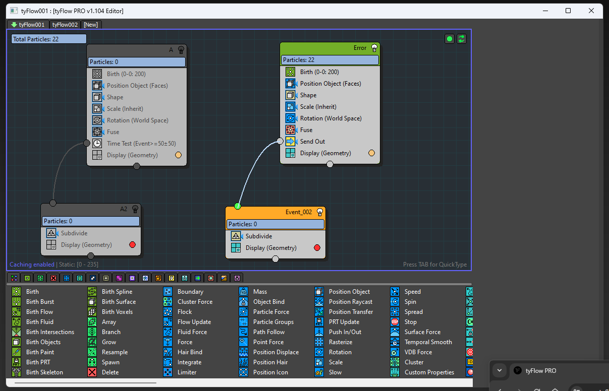

I am using Tyflow v1.104.
We will send you the file.
Event A is sent to Event 2 by TimeTest.
This one works fine.
But the other event is sent using SendOut.
This one freezes max at the moment the events are connected.
I would appreciate it if you could tell me if this is a problem with the way I am doing it.
