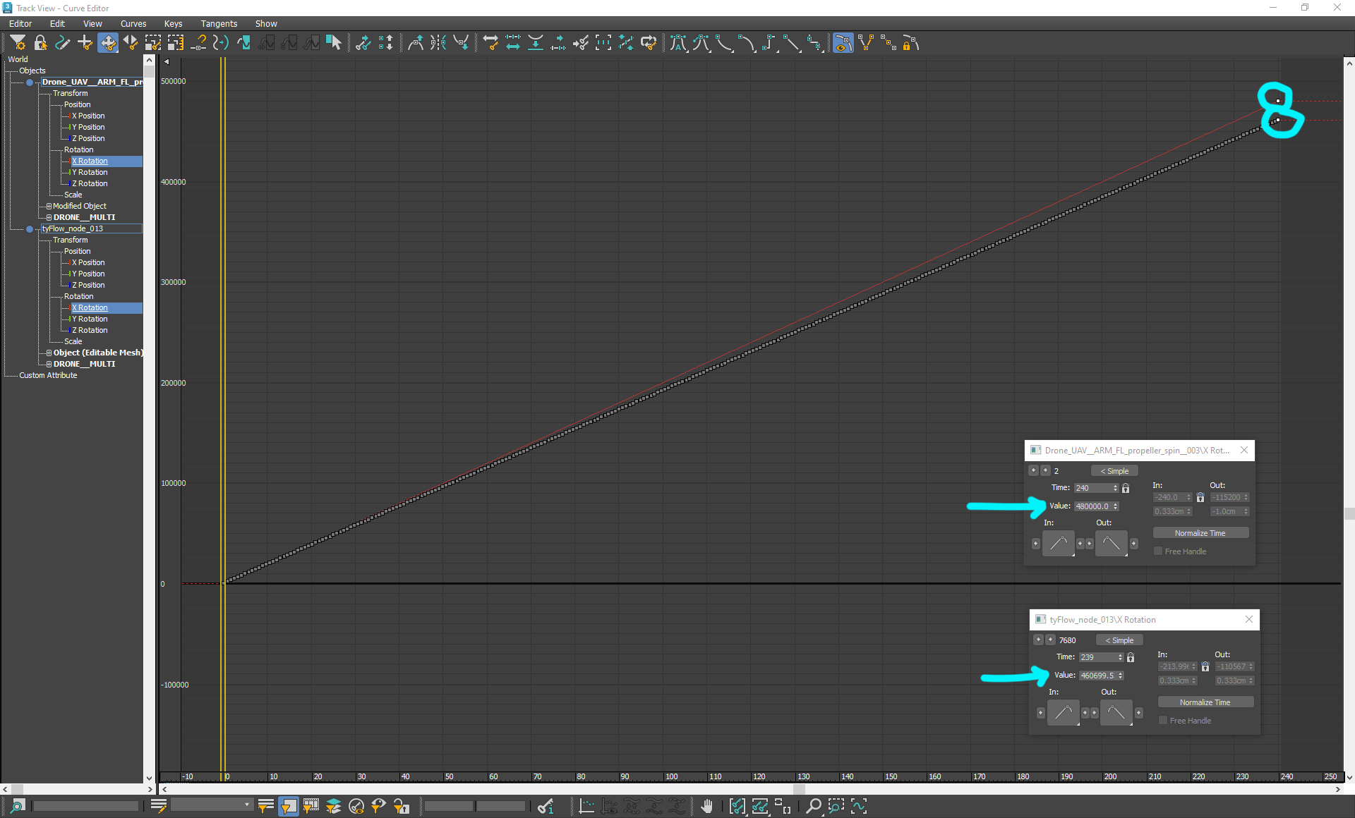

One minor issue, the rotational value still isn't a direct translation. Reducing the time step gets closer and closer and with '1/32 frame', it gets very close. I'm including a screenshot of the curve editor showing the differences.
For my drone project, I only needed a high enough value to achieve the proper motion blur, so these current results work for me! I just wanted to bring this to your attention, should it affect any similar projects that reference this post in the future.
Maybe a potential feature in the future could be implemented in which keys can be directly copied from referenced geometry, instead of baking them (if this isn't already possible)? But that may be rather complicated and only applicable in specific situations.
Yes in the case of your scene, the rotation won't be exactly the same because the tick(s) from where the rotation values are sourced are not the same ticks where they are applied, due to the time step not being evenly divisible by the frame tick count (it's a rounding issue). Luckily that issue won't be something that really matters considering it'll only happen in situations where objects are spinning too quickly to ever visibly be able to determine their exact angular velocity.
