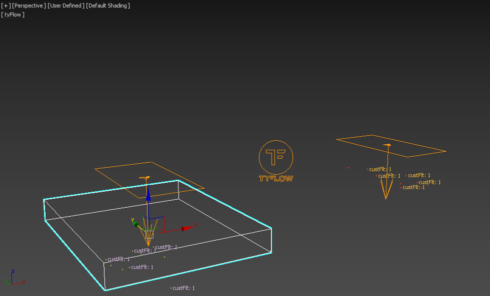

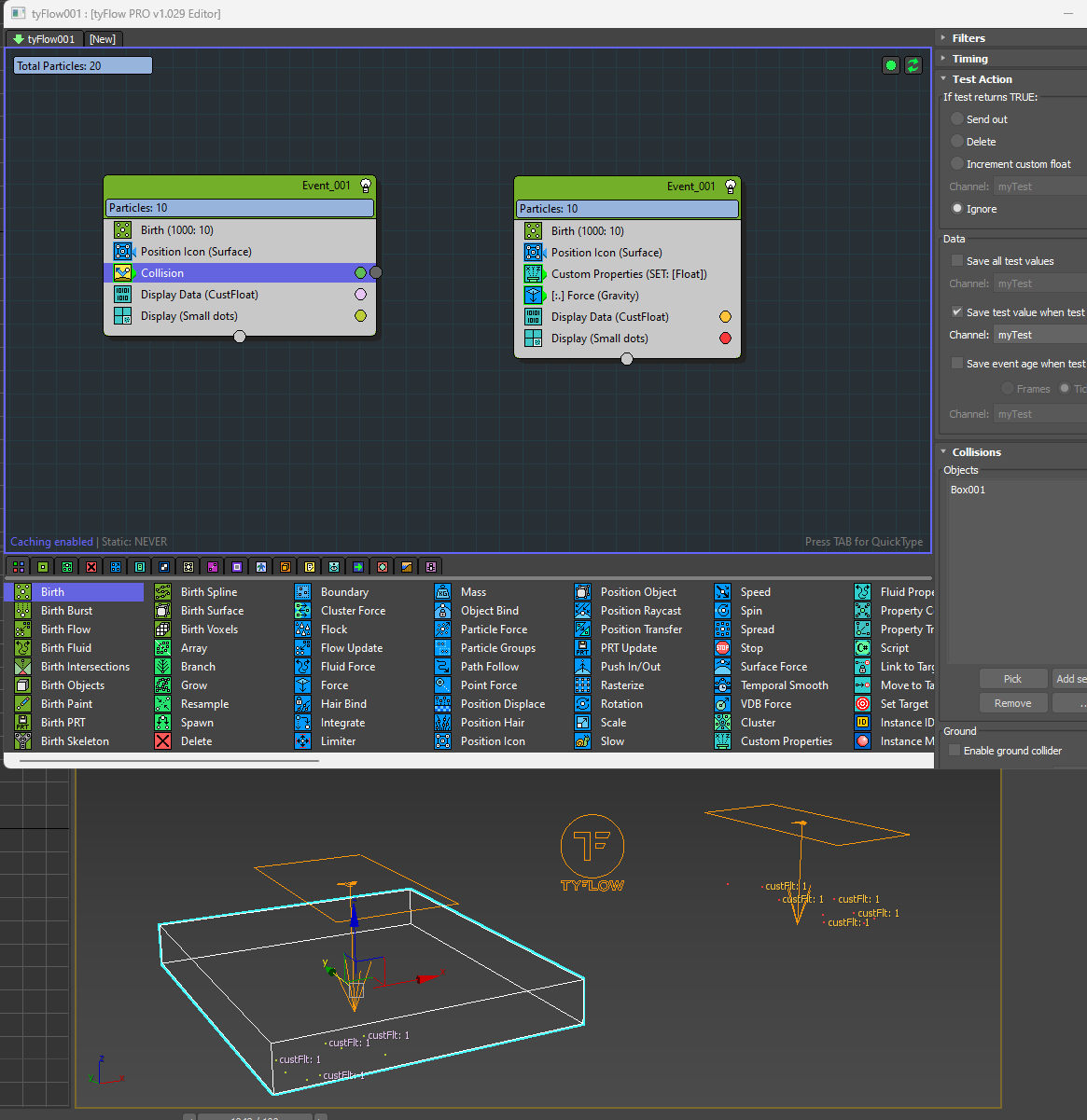

This is what I have.
Both spawn particles on a icon surface. Custom float is 0 by default.
When the collide happens on the left side, test action "the increment on collision", makes the custom float become 1.
On the right side I have set a custom properties to continues update the custom floats value.
And make a test inside the force, to active it if the custom float >=1.

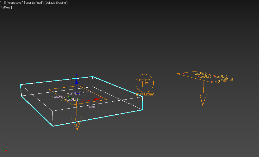

This technique doesn't work in my actual scene for some reason. (I have noticed that if one birth operator is plain and the other is a spline birth operator, then this example above doesn't work)
