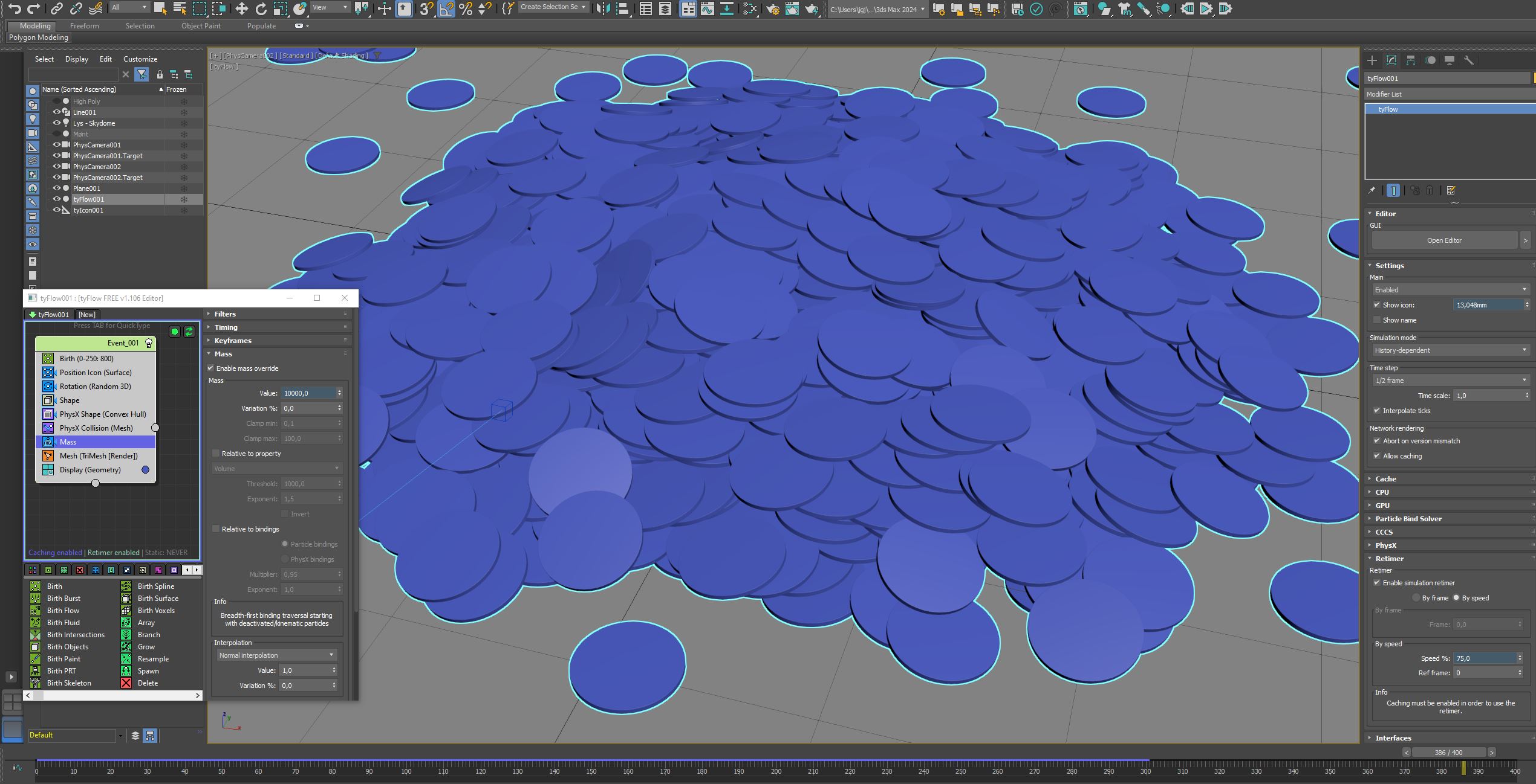

I made theese coins that are falling into a stack, but they keep moving after hitting the plane/coin stack.
You can see it at the end of the animation.
The coin stack keeps vibrating.
How can I fix that?
I added MASS op, but that did not help.
Restitution is set to 0 in PhysX collision and PhysX Shape.

I'm actually not sure why it's not settling to be honest...if you increase PhysX substeps and reduce max PhysX convex hull verts (I tried 32, for example) you can minimize it...but I'm not sure the root cause here. I'm going to look further into it when I get a chance.
