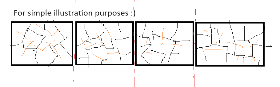

I have a few square tiles placed in a row.
I break them up with Voronoi into smaller pieces, and have them knocked down with a collision.
How do I make sure that the PhysX bind operator doesn't bind across the the individual tiles, and only bind within the tile (element)?
