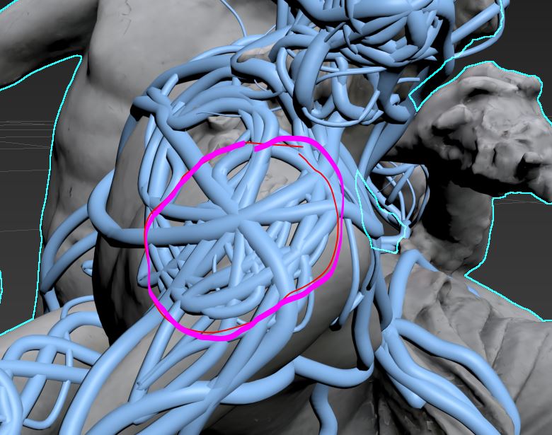

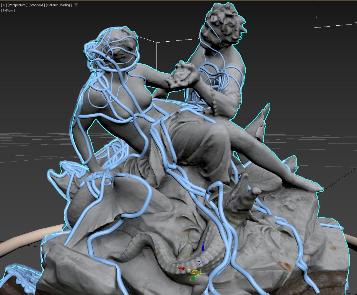

Hello? I have an ivy growth animation that I'm working on and I want the parent particles (and splines) to avoid intersection while tracing the surface of a model. i'm currently using Surface Force and Object Bind. is it possible to allow some wiggle room to allow particles to go over and under each other when crossing? Or is there a better way to set this up entirely? thanks in advance Smile

Hi Tyson,

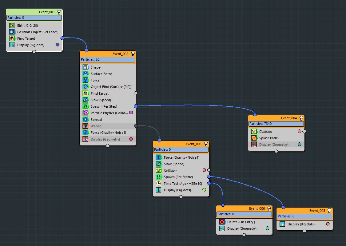

your suggestion seems like a cool workaround, but how do i use particle physics with splines meaning how to test the polys of the meshed splines? I tried using an edit poly modifier on top of the spline mesher as a birth object for using the particle physics, but no luck. Tried using the mesh operator unticked the point "at rendertime", tried tyMesher with epoly on top - all describedin many variants, but still no luck... Confused
Attached you can find my test setup ...
Can you give me a hint please?
Thank you Smile
