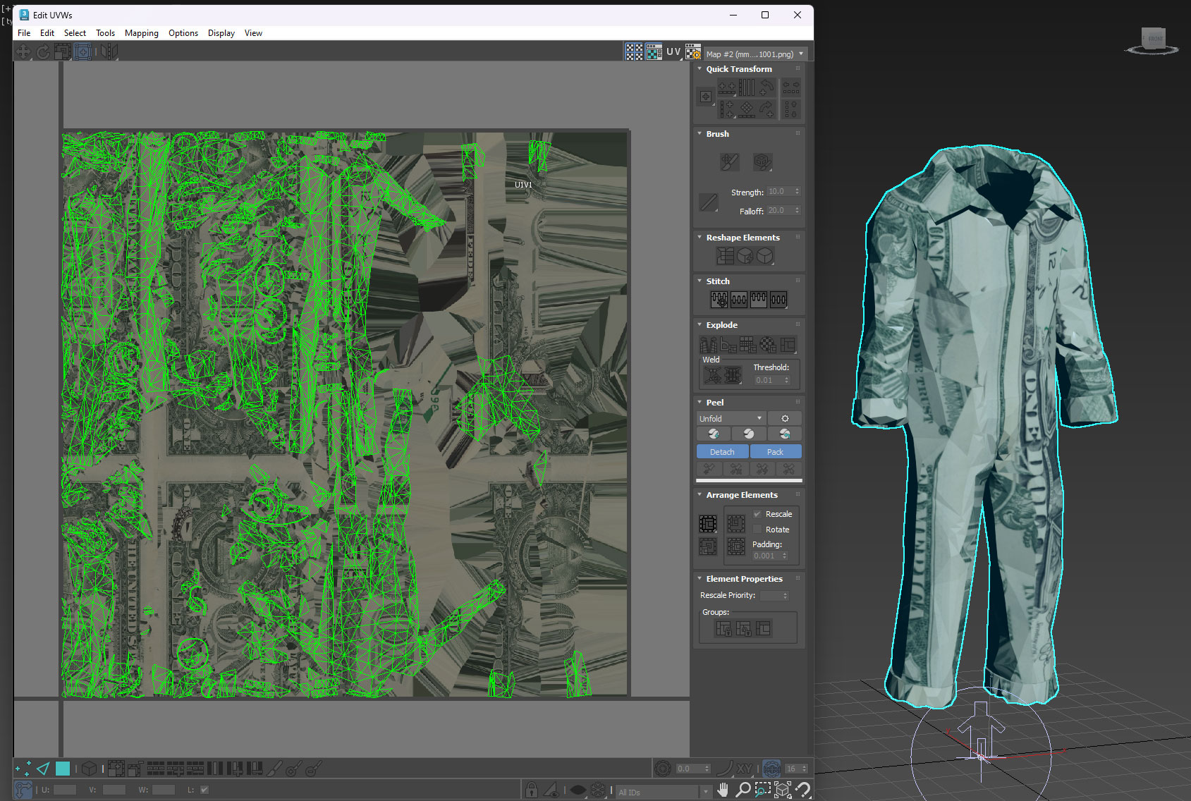

I'm working on a quick turn around piece and have done some really quick flat mapping.  I've got this rigged and skinned and then running this through tyflow to do the effects I need and then exporting the alembic file to unity3d.
The original layout looks like this

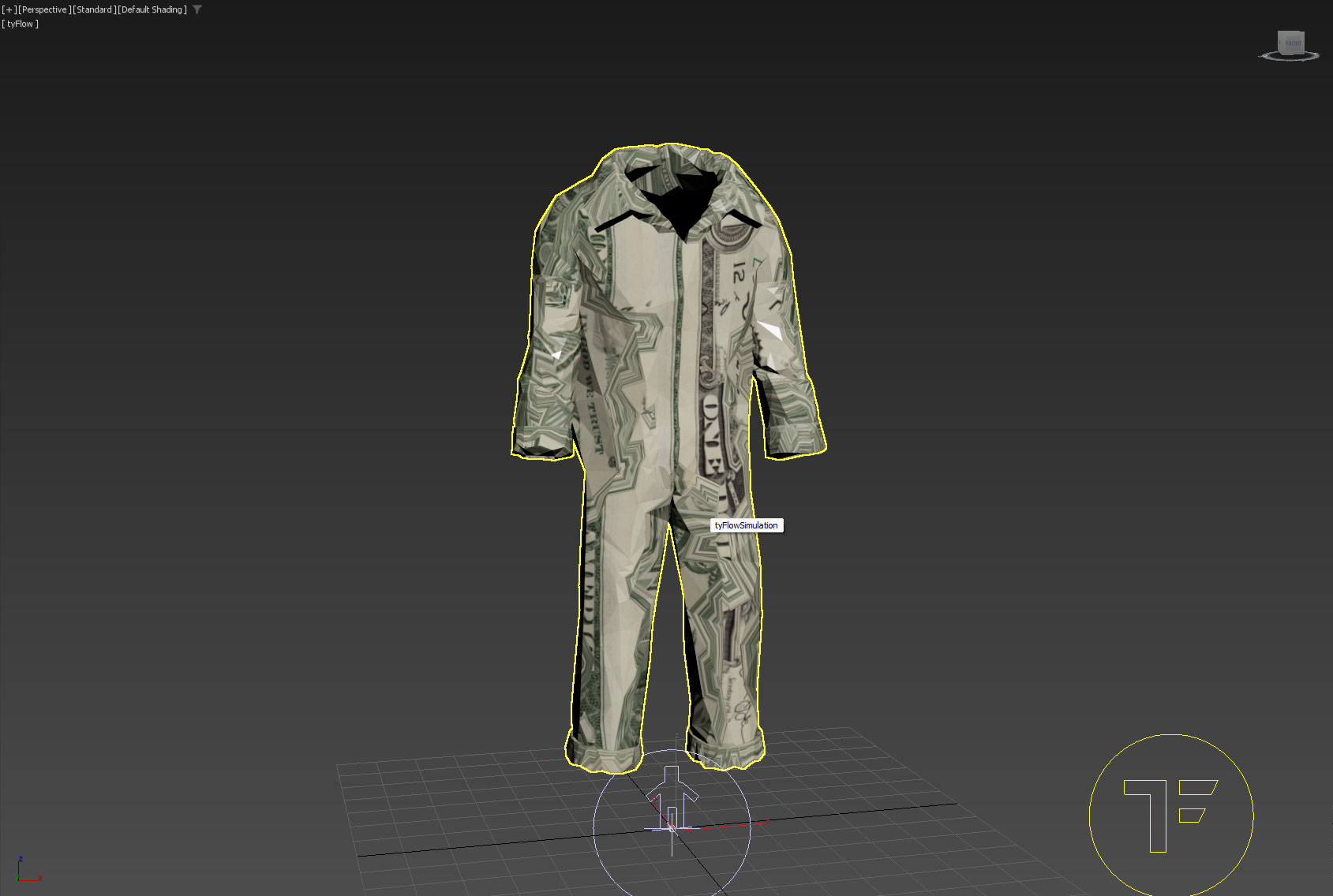

When I run this through TyFlow I can see some stretching happening.

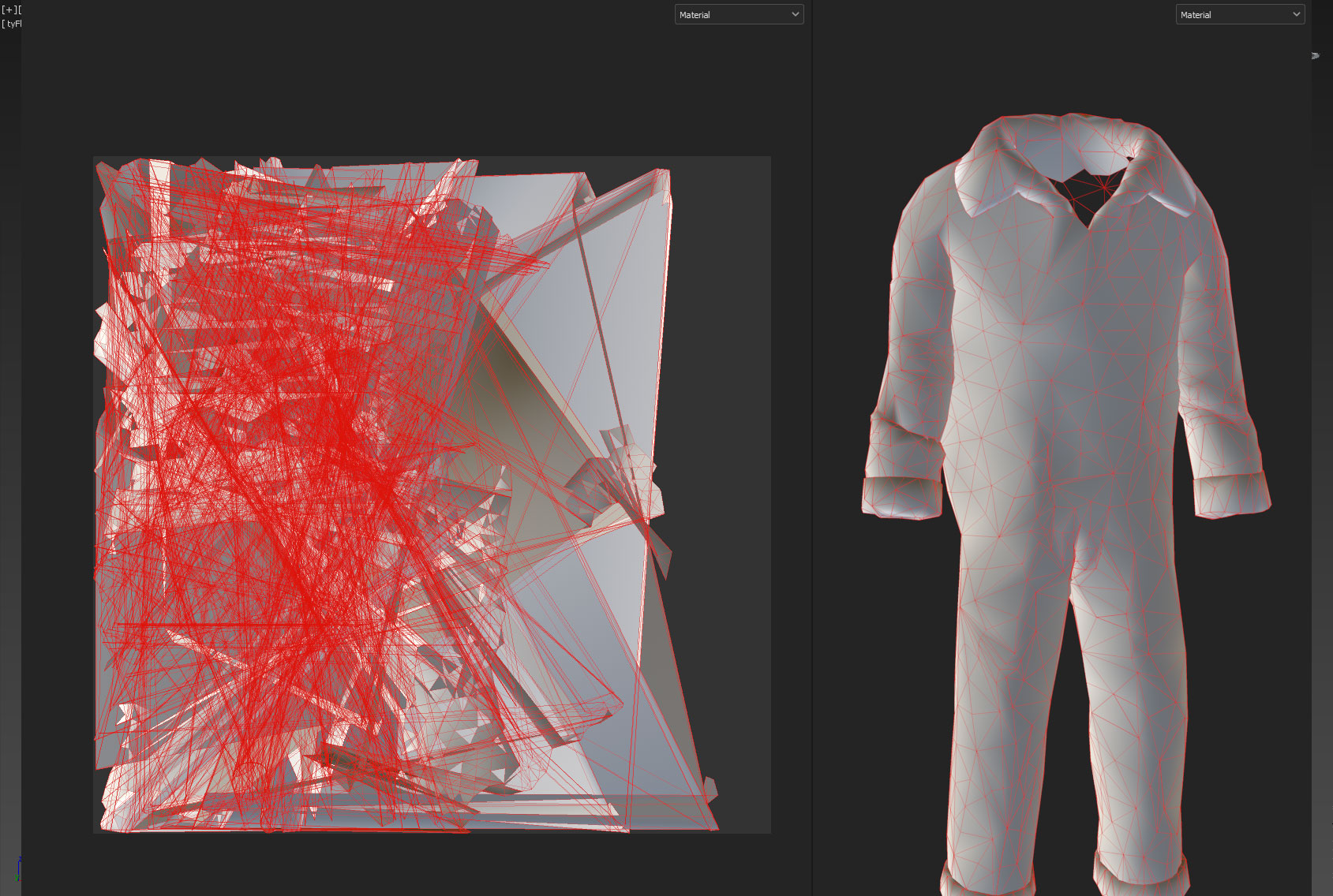

When I load this up into substance painter, I can see the UV seem to be intact but there is a lot of vert wielding happening.

You have a Mapping operator assigned in your tyFlowSimulation flow...not sure why (perhaps an attempt to fix the UVWs?), but the real solution is to disable that Mapping operator, and also disable "inherit mesh UVWs" in the Cloth Bind operator.
That setting assigns mesh UVW values to particle mapping values...but in your case, because you have seams that connect at shared vertices, that is creating stretching artifacts. By disabling that setting you won't have any particles inherit those seam UVWs, and thus no particle will override the base mesh's UVWs with its own (artifact-prone) mapping values.
(04-18-2024, 04:05 AM)tyFlow Wrote: You have a Mapping operator assigned in your tyFlowSimulation flow...not sure why (perhaps an attempt to fix the UVWs?), but the real solution is to disable that Mapping operator, and also disable "inherit mesh UVWs" in the Cloth Bind operator.
Thank you so much for taking the time to look into that.  I'm kicking myself, I thought I had tried all the UVW switches.
