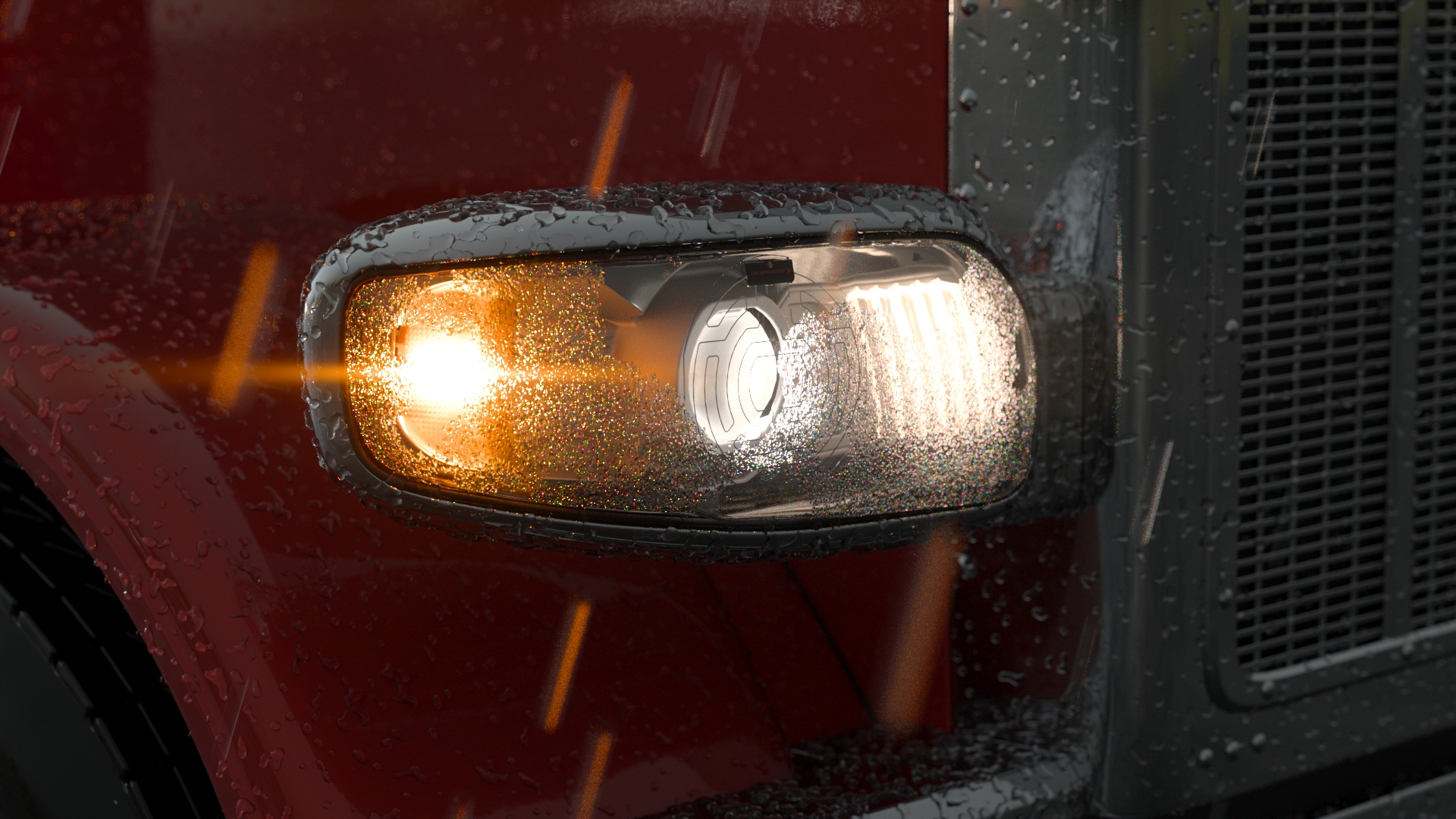

Hello Everyone,
I know I am suuuuper late to the party, but I've finally been able to start playing with this incredible particle sim!
I've been testing the Beta version 0.16134 and was wondering if Motion Blur is part of this version?
I am using Tyflow Beta and Fstorm Render to do a very simple rain scene.
I have been reading up on triggering the Motion BlurĀ for the past couple of weeks on this forum, but I haven't found any solutions. Sad
Any help/direction would be greatly appreciated.
Best,
O
Whoops! I gave up too fast!
SOLVED:
Right-click Tyflow, activate Fstorm Moblur.
Enable particle interface.
No Tymesh.
Enable motion blur in Fstorm.
Done.
