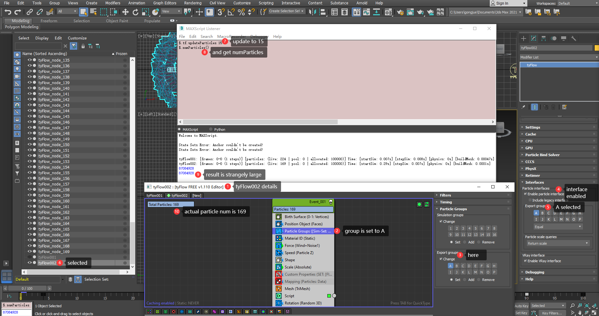

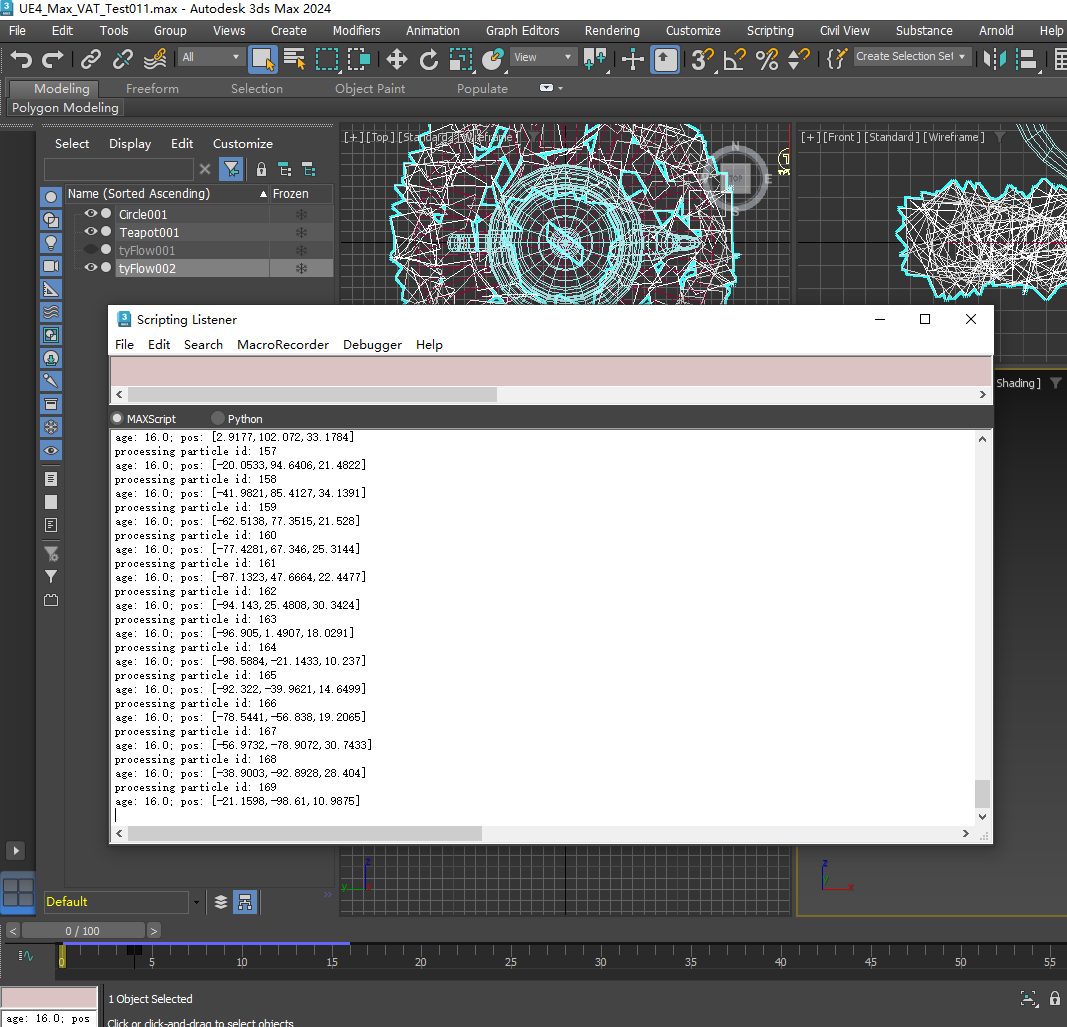

Yes, I did call updateParticles first. As in the post image, the first line is $.updateParticles 15.
I also tried to write those code into a ms script. The result is also the same.

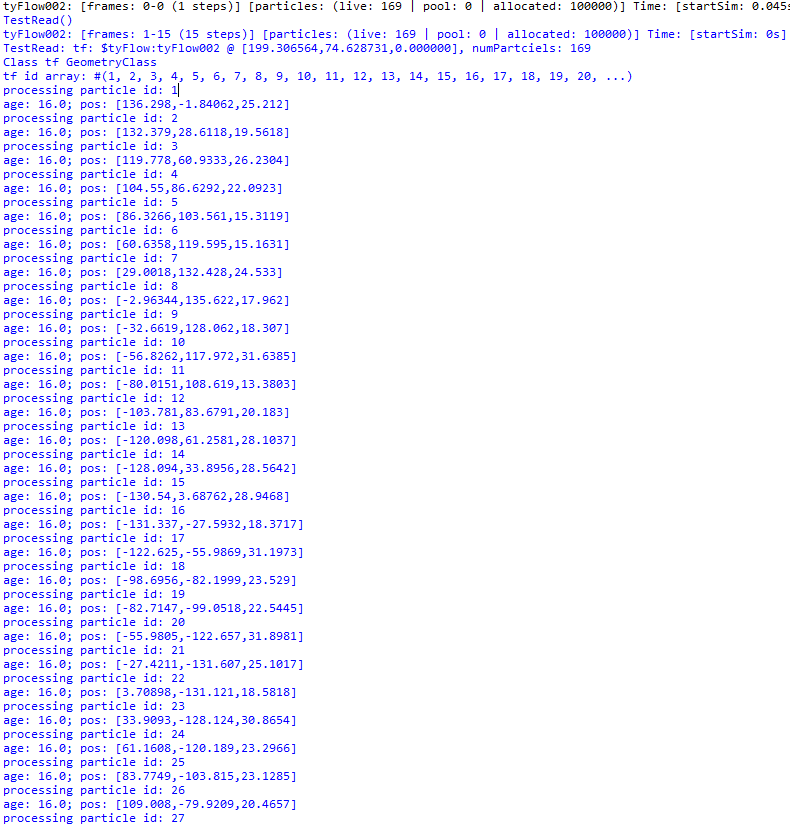

By the way, I can get Id from getAllParticleIDs(), when I have 169 particles, the array is properly filled with (1, 2, 3, ..., 169). But getParticleAge always returns 0, getParticlePosition returns (0, 0, 0) no matter what frame number I gave to updateParticles() function.
I attached my max scene and script run result.

the result is
