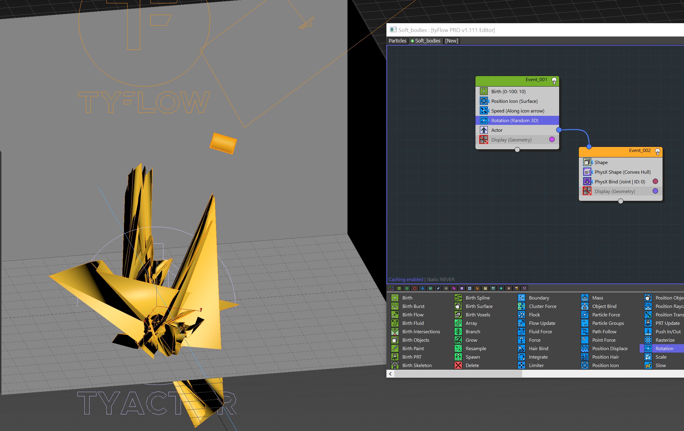

I'm pretty new to TyFlow so bare with me.
I've been trying to follow this softbody tutorial on YT. https://youtu.be/YUvggZvwy7s?si=j_y3GKkb-TxDNPll
But I'm having problems with the PhysX Shape or PhysX Bind or both.
When my object hit's the ground the faces/verticies seem to distort/explode as you can see from the screen shot.

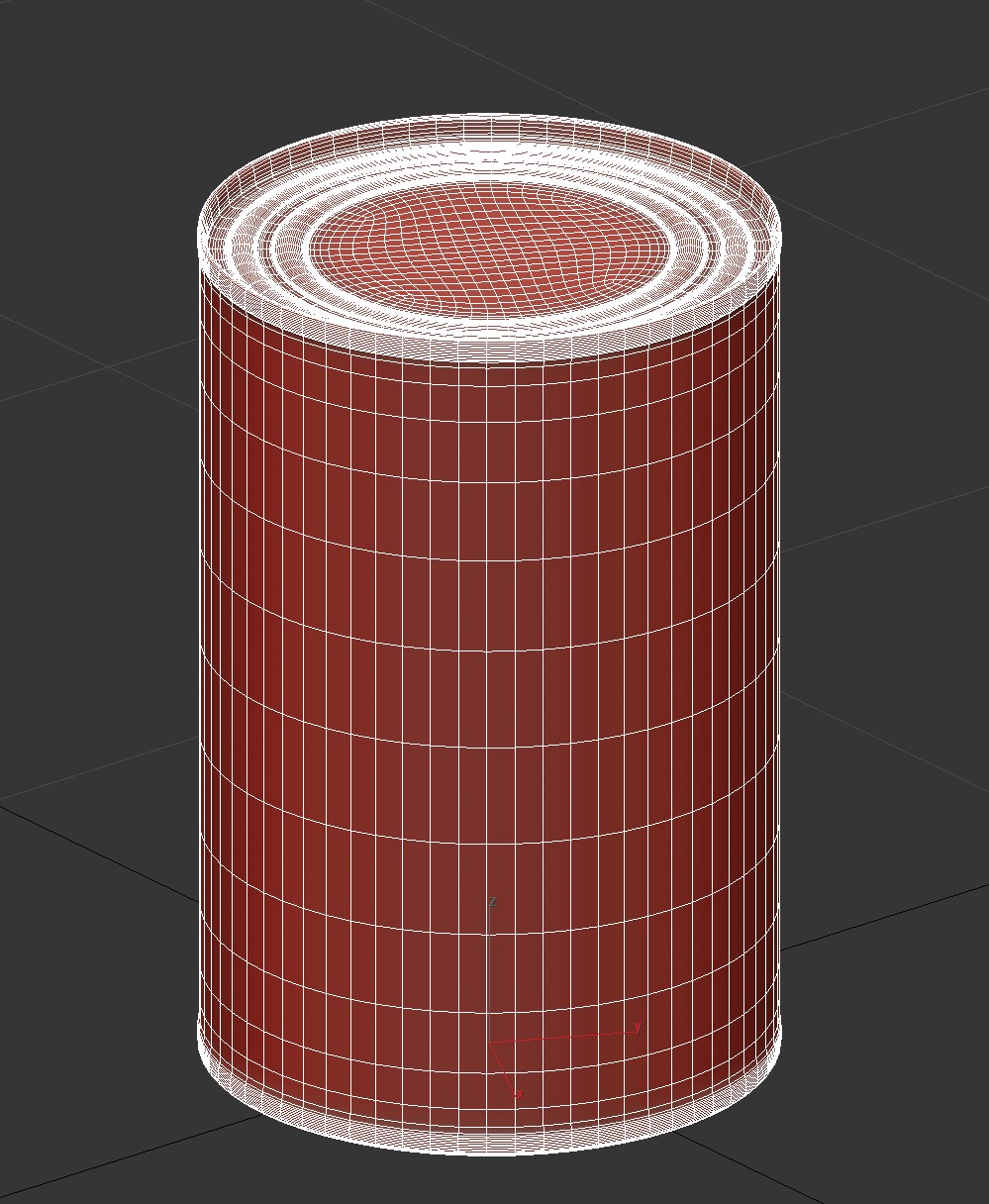

this is the geometry being used

This problem was sorted by increasing the shape scale.
