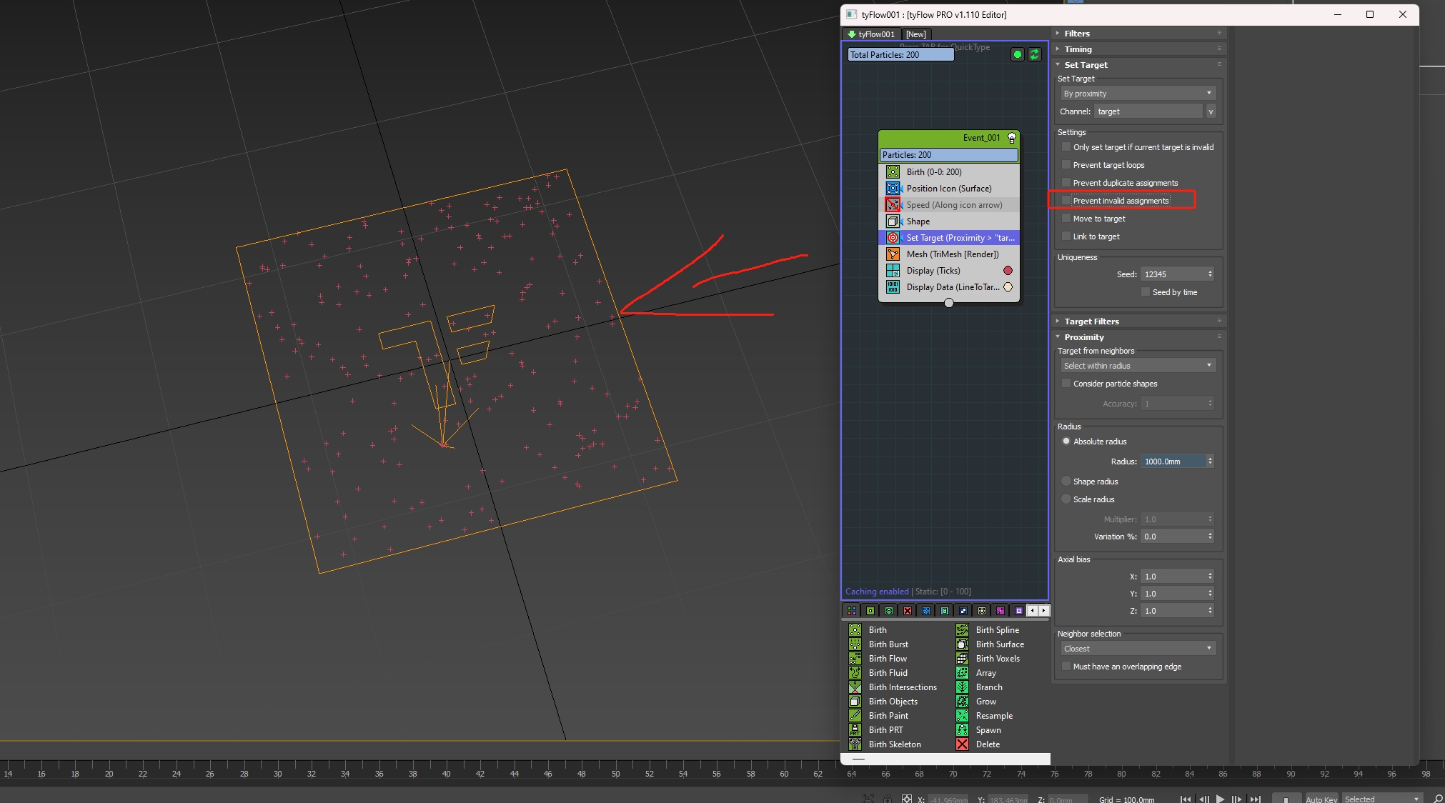

The 'closest' mode of the 'Set Target' operator has no effect. For example, random and other modes are not a problem. Please check
Tyflow1.10 version!
I have sent this issue to your email, and I am not sure if you have received it, so I am posting it here.

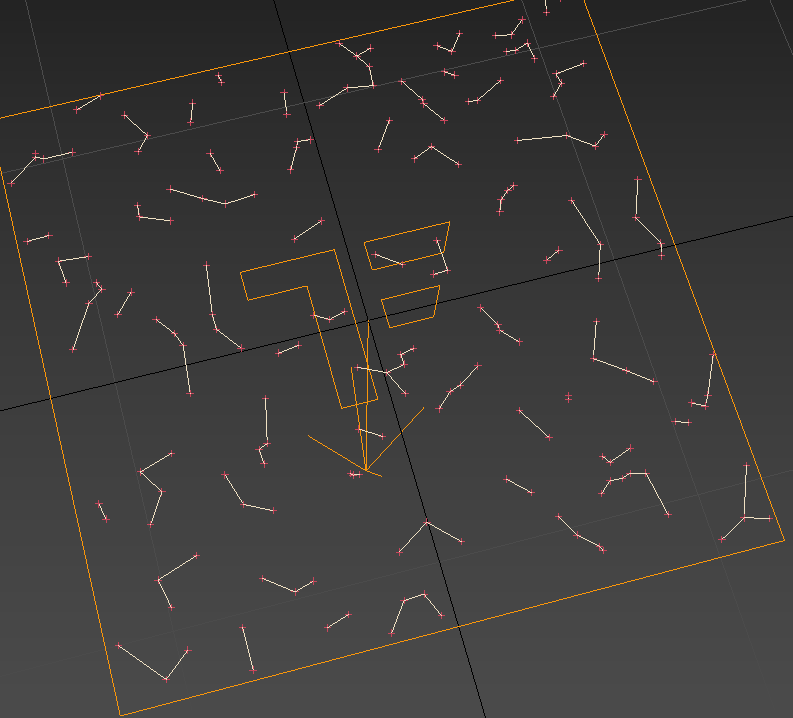

I opened your file and this is what I see:
...seems to be working as intended?

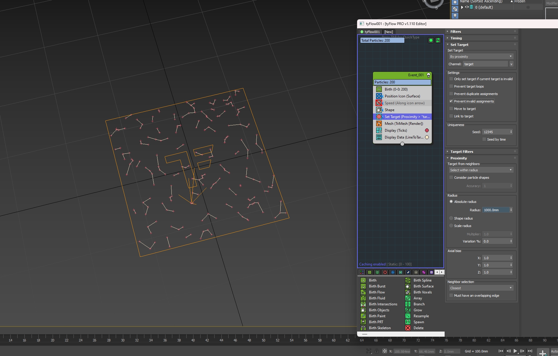

It seems that "Prevent invalid assignments" need to be checked to take effect. I remember there was no need to check this option before.
.mp4   afff.mp4 (Size: 13.34 MB / Downloads: 153)
Oh actually, I forgot I fixed that in my current pre-release build already, which is why I couldn’t see the issue when I tested your scene. So, will be fixed in the next build.
