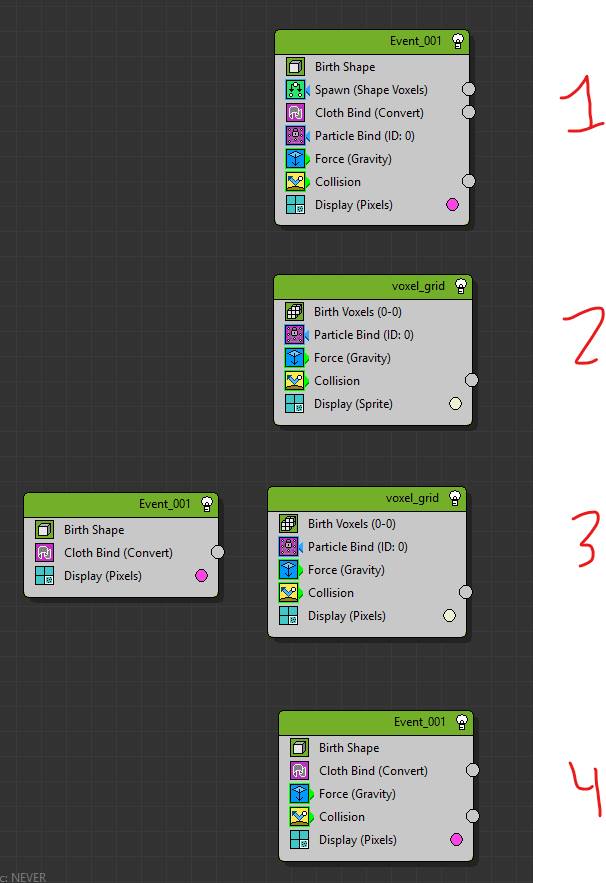

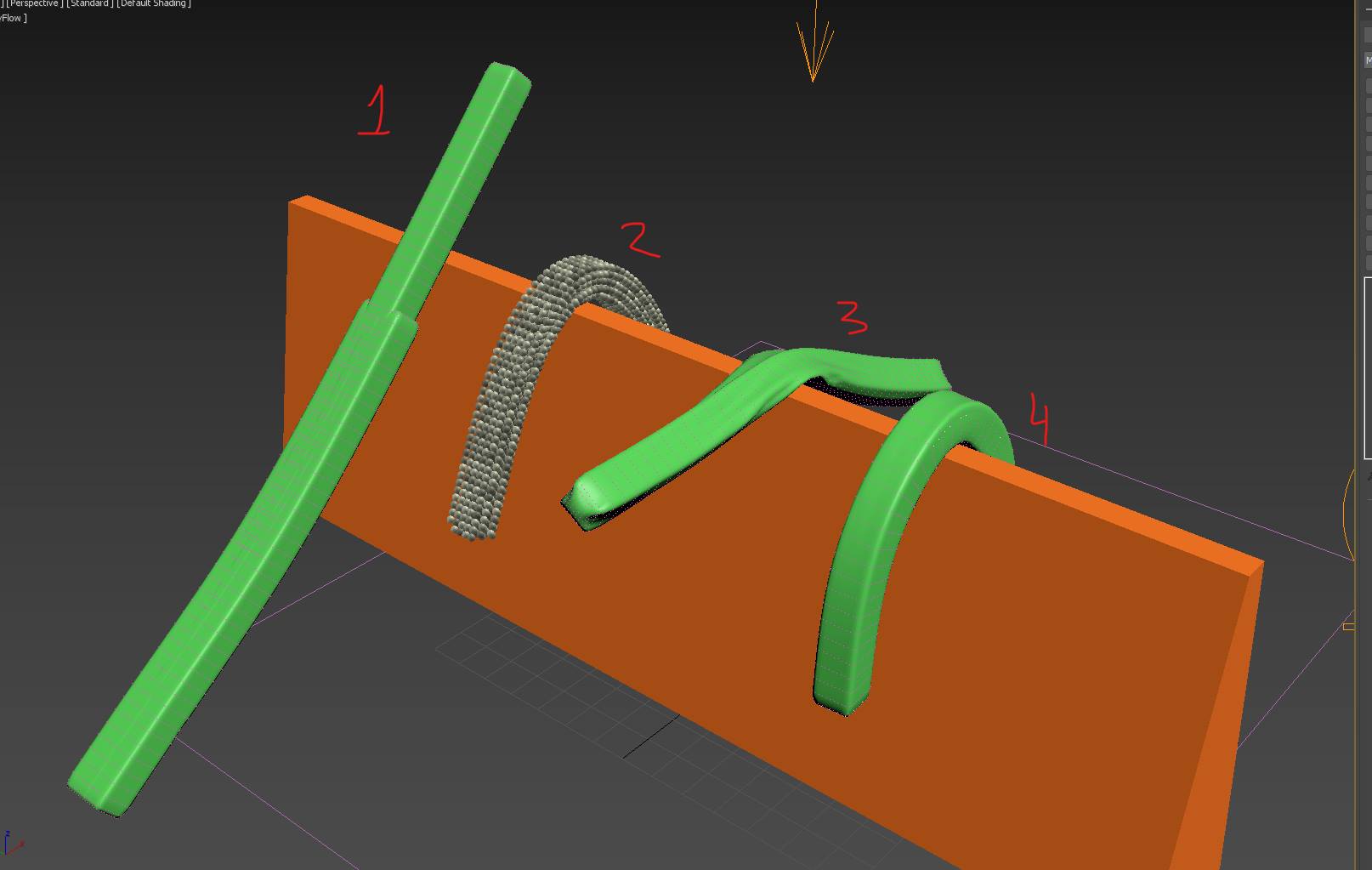

and then ... there is this other method I just found by accident.
1. the proper method (or my try about it) described in the manual for soft bodies.
2. the birth-voxel method.
3. the binding volume stiffness.
4. the weird thing I found by accident that kinda works. ( its not the exact same result as the birth-voxel method, but close ) and uses two, not connected,  set of nodes... is this normal?
here some pictures and max file.
.max   fisics_02.max (Size: 560 KB / Downloads: 625)
The volume stiffness is identical to Houdini Vellum struts and isn't really that great for achieving stiff softbody forces. It's better in situations where you need a small amount of volume binding strength to help maintain the shape of a flexible surface (think: hot air balloon).
The best way to simulate stiff softbodies is similar to your #2. The steps I would take are the following:
1) spawn voxels in a particle and send them to event #2
2) convert the same particle to cloth
3) in event #2, use a particle bind to bind all your voxels together as well as to the particles that form the cloth
That will give you a deforming surface (cloth) that is strengthened internally by the matrix of voxelized particles within. Those particles shouldn't be made renderable and instead exist only to reinforce the internal structure of the mesh.
Keep in mind binding strength is tied directly to sim substeps. For a sim like this you'll want probably 1/4 or 1/8 substeps, with bind solver substeps probably being in the range of 20-25.
