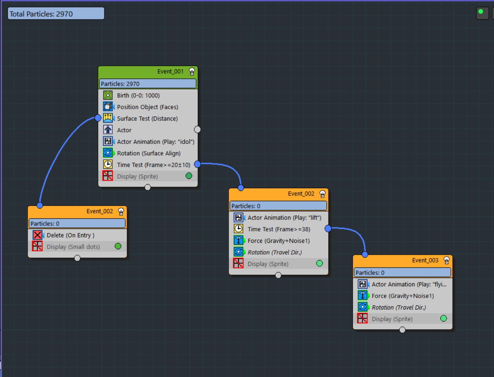

Hi, I am trying to simulate insects taking off. It all works well but i can't seem to get a smooth transition for the rotation as they jump to different events.
The first event has the insects surface aligned and the next is travel direction, but the transition is instant rather than gradual

Is your rotation operator in the second event set to continuous, and interpolation set to value lower then 1.0?
If not - try it.
(05-28-2024, 02:13 PM)d4rk3lf Wrote: Is your rotation operator in the second event set to continuous, and interpolation set to value lower then 1.0?
If not - try it.
Interpolation set lower than 1 worked thanks!
