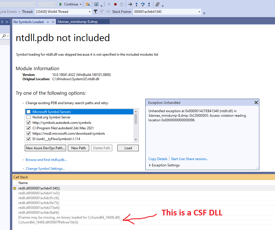

A piece of software on your machine called "CrowdStrike Falcon" is causing the crash. Try whitelisting 3ds Max/tyFlow within CSF's settings to work around it.
(06-17-2024, 03:51 PM)tyFlow Wrote: A piece of software on your machine called "CrowdStrike Falcon" is causing the crash. Try whitelisting 3ds Max/tyFlow within CSF's settings to work around it.
Hello, I suspect I'm having the same issue, would you be able to confirm? Dump file is attached.
.dmp   3dsmax_minidump.dmp (Size: 2.53 MB / Downloads: 350)
Yes, same issue. It's CSF causing the crash.
