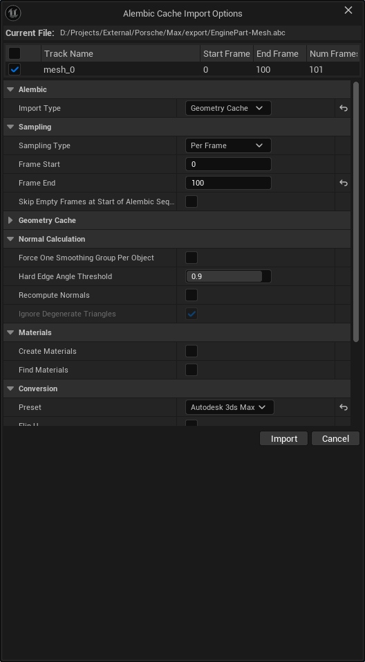

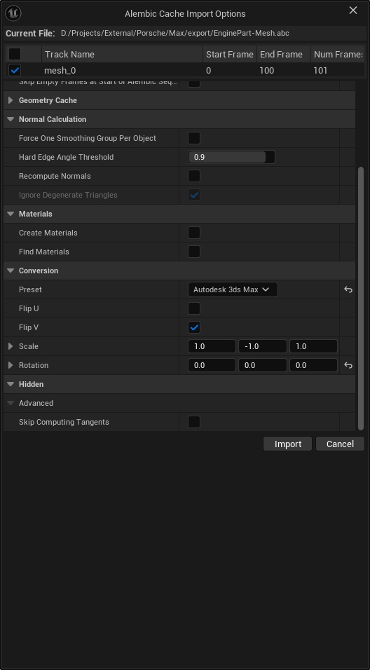

What do your unreal import settings look like?
(07-05-2024, 11:17 PM)tyFlow Wrote: What do your unreal import settings look like?
Pretty much default settings; I've tried every possible combination there is.
Tried "Force One Smoothing Group per Object", as well as "Recompute Normals"; no change whatsoever.

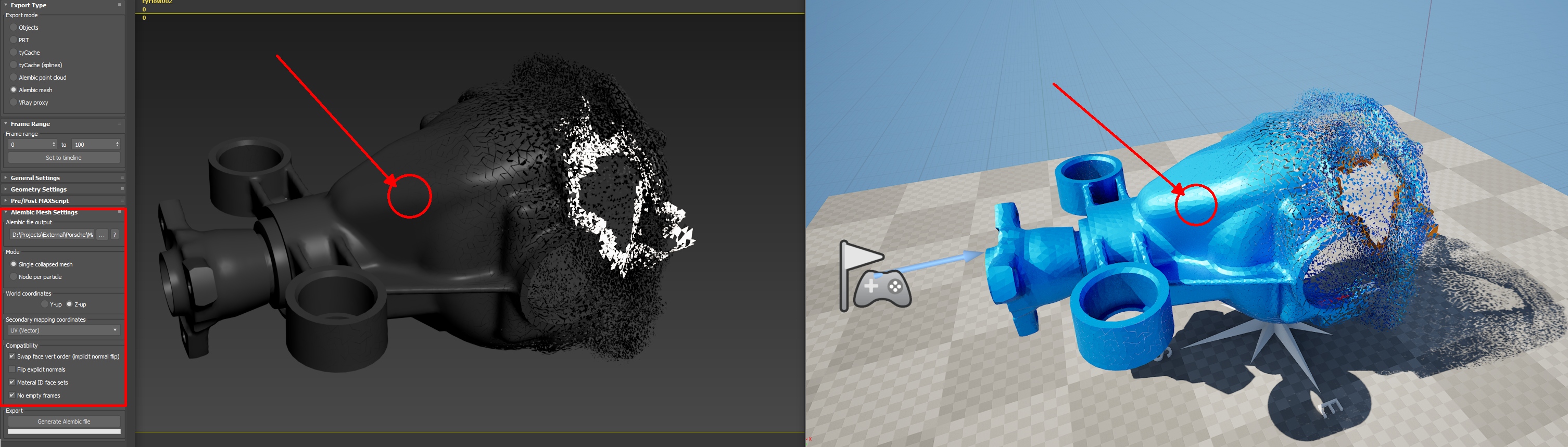

Hm...
Still can't get it to work; I'm getting no explicit normals in UE.
Is there anything perhaps I should do differently?
Or, is it UE that cannot handle explicit normals at first place?
Hmm, you know what, I may have jumped the gun on claiming the issue was fixed...I was verifying my changes with some simpler test geometry and the normals were exported correctly, but now that I re-verify with your original geo (something I forgot to do), the normals are not coming through. I'll need to do some further digging to figure out what's going on...
