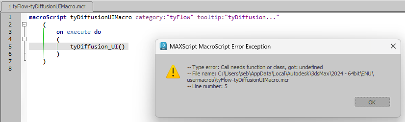

I tried to run as administrator and install it again but then I can't open tyDiffusion! (See screenshot)
[Edit] When I remember right, the difference to previous versions was the missing installation path for ComfyUI. In the build before I set a different path on drive D: not C:. In the new build I could not set it.
Could this be the reason?
#10
I mean…the screenshot you posted implies tyFlow isn’t even installed.

You are right. TyFlow was not loaded. We have a mapped network device Q: which isn't available when starting MAX as admin. Sad
I changed the path to IP and then TyFlow works again. But after updating ComfyUI the issue is still there.
