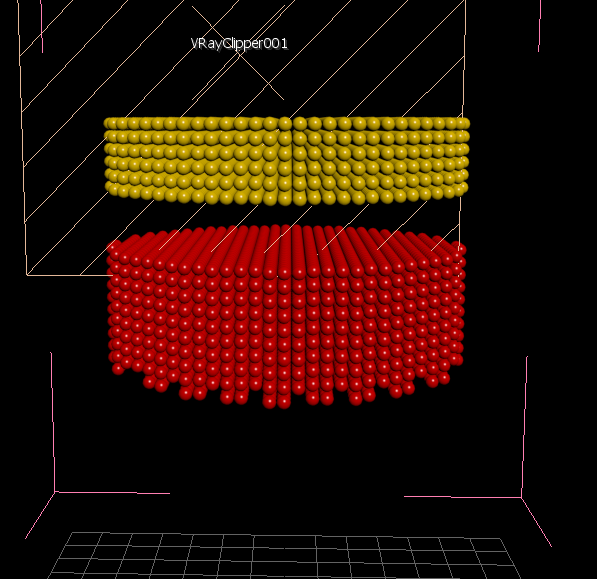

Hello, i have a collision problem of two types of particles. I try to blend them in a container.
I tried everything, but they intersecting. The collision between the different types of particles does not work well. Anyone has an idea?

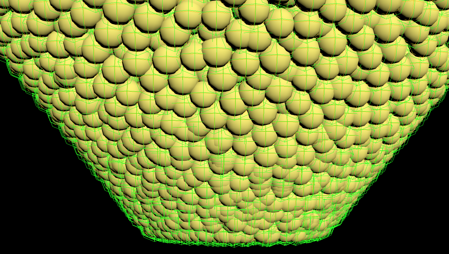

In the Particle Physics operator, on the bottom you have option "draw collision shapes".
Turn that on, then tweak multiplier option, until they match your spheres in radius.
When you are done, turn it off (because it can slow the viewport)

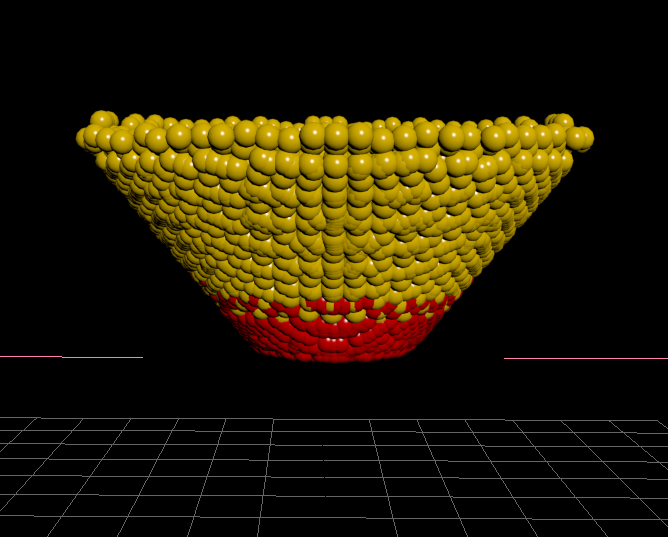

Thank you for your reply, this helped a bit.
I think there is a further problem. In this case the particles where crushed? Maybe its a force problem?

The collision shapes looks good now, btw. Smile
Thank you very much, this helped a lot! The particles now staying inside collision container.

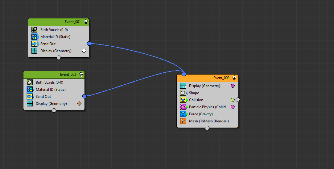

So you have collision operator too?
Glue.. like stuck?
Did you try to reduce default friction parameter in collision operator to zero?
Yes i used the collision operator, all friction parameters was at 0.0 and 0.5. After i changed the time steps to 1/4 everything was ok.
