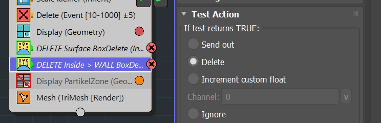

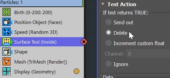

Surface Test with Test Action "Delete", does not import properly into the next tyFlow with BirthFlow.
It only works, when I send out to a delete event (which messes up my flow, I have in my scenes more than 10 surface tests).
Reproduce:
1. Just delete with a surface test particles
2. import that into a birth flow and the deleted come up again...

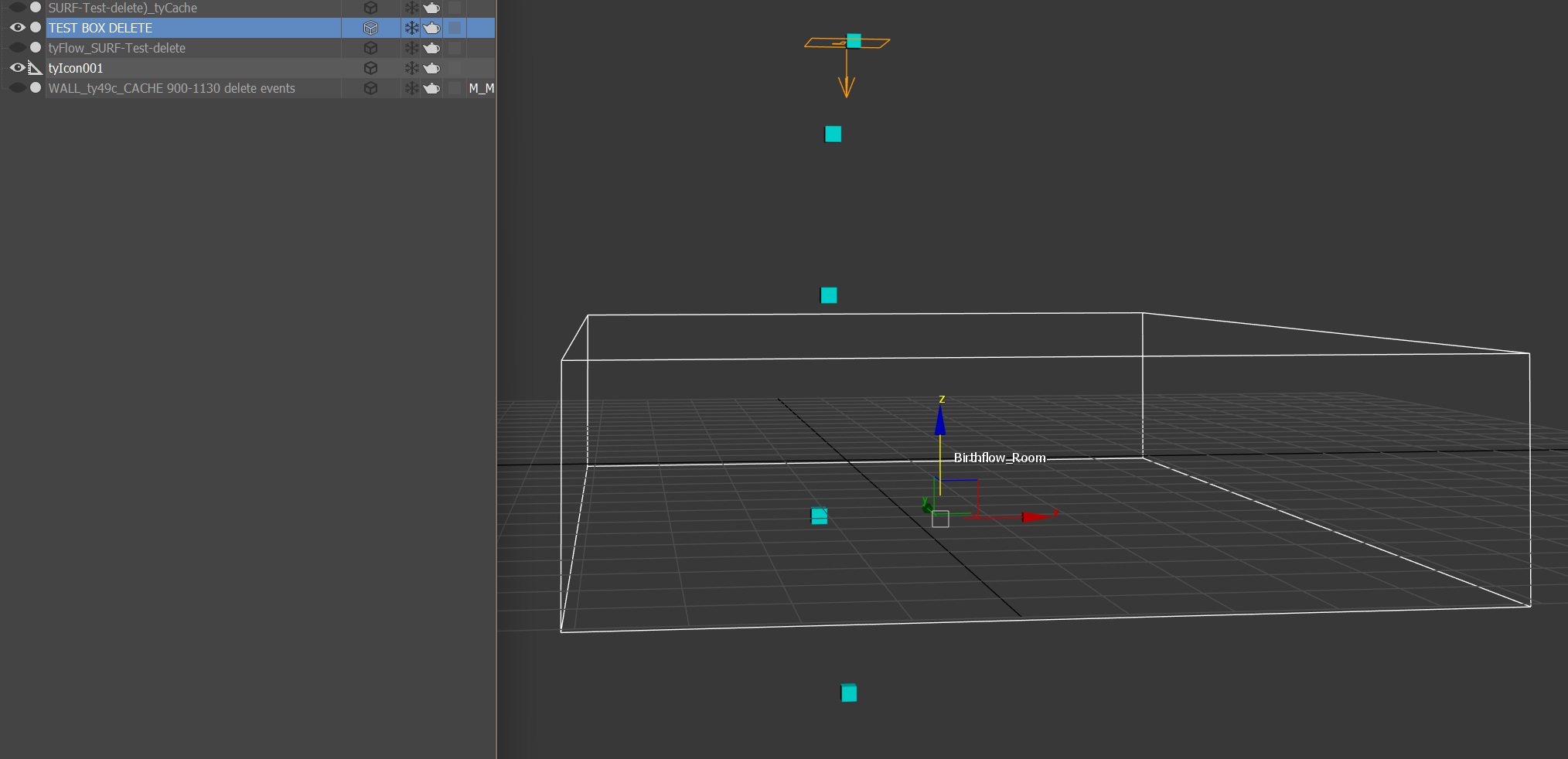

Attached the example scene with screenshots... very simple to reproduce.
You will see that the boxx deletes the right side, but those come back when imported into birth flow or in tyCache.

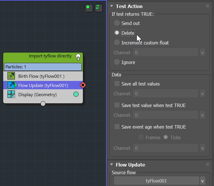

This is not a bug - you're just not deleting the particles when they go missing from the flow/cache.
As noted at the bottom of the Flow Update operator, particles will test TRUE when their matching ID is missing from the source. Just set the Flow Update operator's output mode to delete (or send to a deletion event) and the particles will be deleted.

Okay, the setting works (attached screenshot)
And then I guess I can use the "delete" function for surface test without downsides)

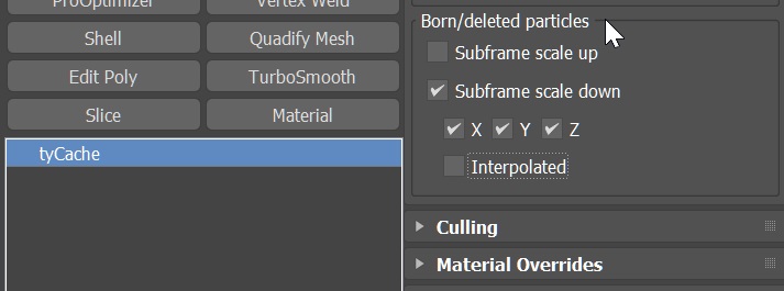

For the tyCache I had to set this at "Element" - is that correct?
