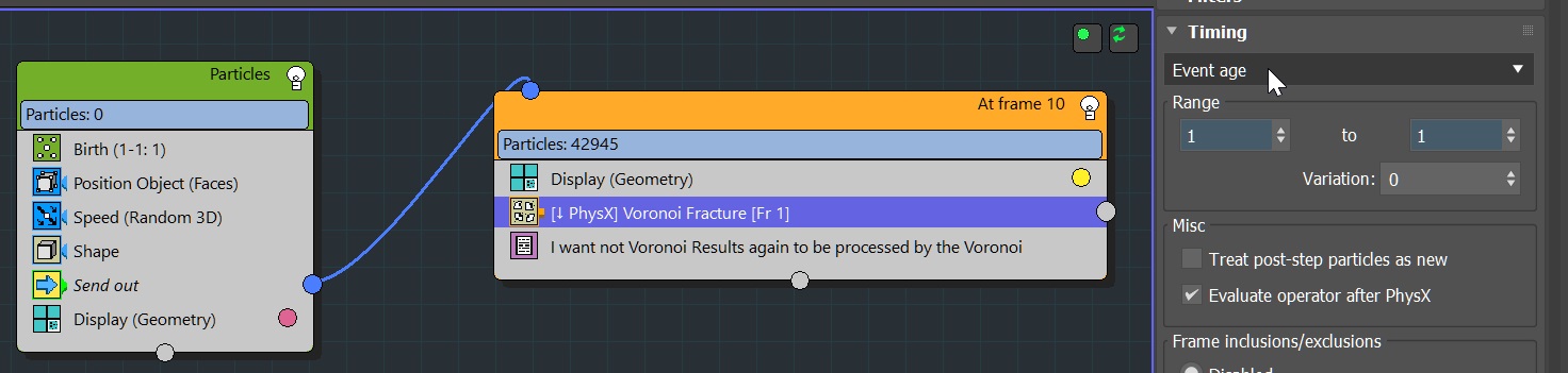

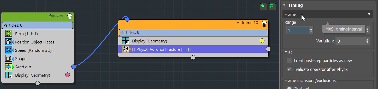

I want to set a certain event age only for INCOMING particles, not for particles new born inside the event itself.
Example: If I have a Voronoi on Event Age I don't want it to process it's own fragments again.
Especially as small mistakes here can cause many minutes of waiting time and crashes.
Please see Screenshots with NOTES in the event.
Many thanks
It should be the same amount of particles possible with both evaluation methods.
Add a Custom Properties operator after the Voronoi operator and have it assign a non-zero value to some channel. Then enable a filter in your Voronoi Fracture operator that causes it to only process particles with a zero value in that channel. Or just send the fractures to another event.
Thanks, I will use it.
But maybe an integration makes sense? "Don't process children"
It's one operator less needed and needs no science with channels Wink
