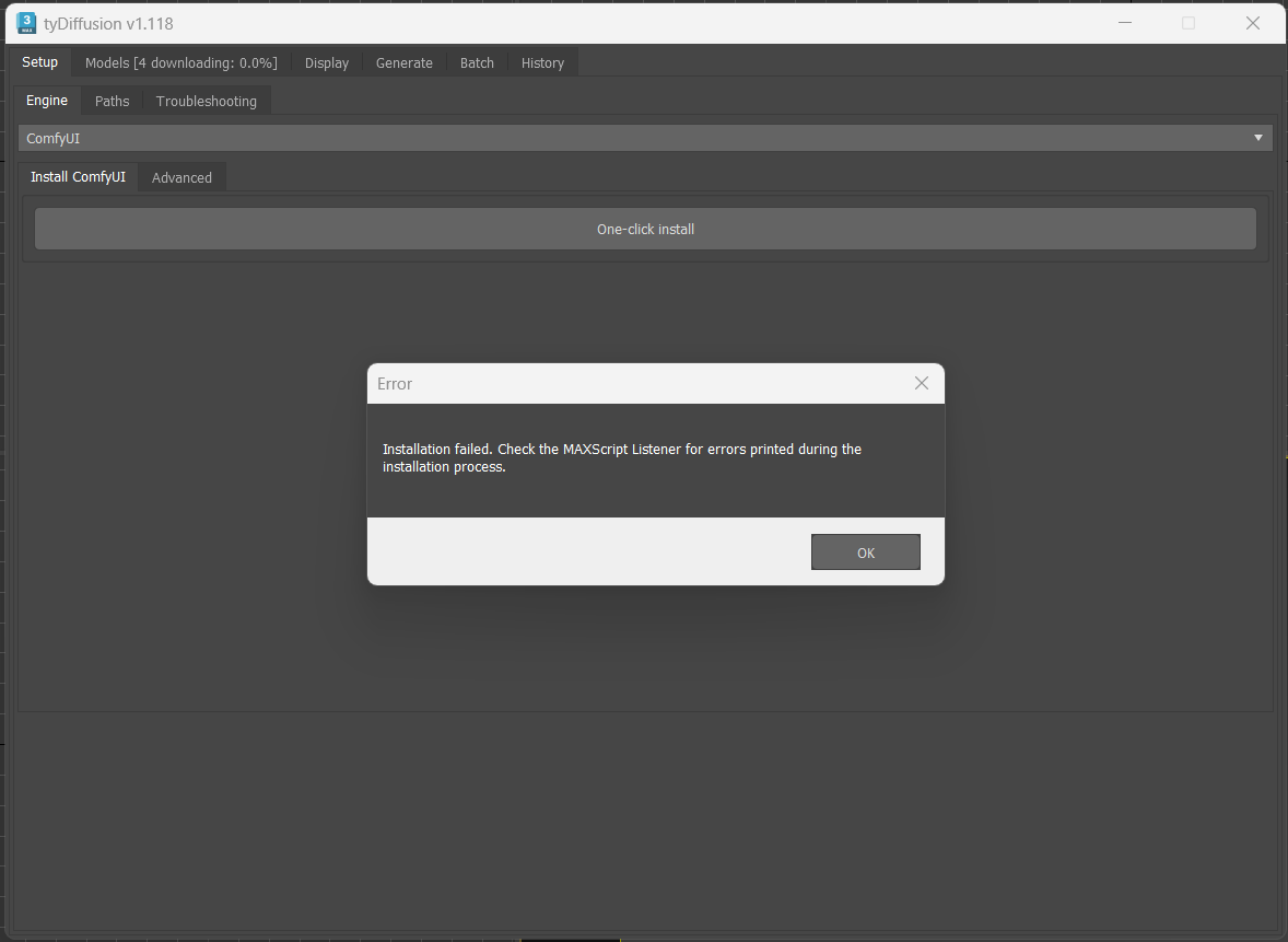

I am quite new to this, so please bear with me.
After installing tyFlow into Max 2024 I've tried running tyDiffusion and installing ComfyUI from the menu. However, the process gets interrupted every time.
I have tried all the solutions I could think of:
- running 3DS Max as admin (while also manually lifting permissions for .exe, just in case)
- shutting down firewall and even AV completely
- adding all permissions to the tyFlow folder
- installing it to a custom directory and even another drive
yet, the problem persists...
Could you please guide me out of this mess? Hopefully, there should be some solution.

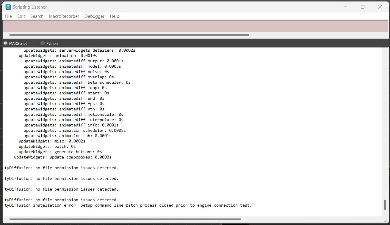

Please see: https://docs.tyflow.com/faq/AI/#nbsp-i-g...ese-errors
And then send me the 3 logs.
...and then send me the 3 logs.
Just sent them to you in a pm.
An update: We haven't been able to find a solution to this issue and I am unable to install or use tyDiffusion. ComfyUI portable works fine so I believe it is not the issue.
I am attaching links to a complete list of logs to this message. If anybody ever encountered similar problem and/or has a potential solution - please do share.
https://1drv.ms/i/c/4fef720136073c89/ERt...2qn-nEg5kA
https://1drv.ms/i/c/4fef720136073c89/EVL...5H-Sn5VUwQ
https://1drv.ms/i/c/4fef720136073c89/EbC...4uV040ZyCg
https://1drv.ms/u/c/4fef720136073c89/EbQ...NUlnaOUb9w
https://1drv.ms/u/c/4fef720136073c89/EaG...pY2x_kqgPQ
https://1drv.ms/u/c/4fef720136073c89/EQT...hyvD3DPi1A
I have I an update, a confusing one...
While trying every possible solution over last few days, demolishing my PC with commands and god knows what, somehow an "Administrator" account appeared. I suppose it is that "hidden" account in Windows... Anyway, out of curiosity I started tyD installation and it went through just fine and everything works, fluffy cat and all that stuff...
However, it is happening under this bogus account. I still can't use it under my own, even though it has administrative privileges.
Thoughts? Am I missing something?
It was a certificate issue: 24x07.co.yu Digitrust CA (!?) provided by Asseco, a crappy asee solutions company. Basically, it is governing token manager and digital signature provided by local authorities, banks - in other words Serbian state.
So, I imagine anyone from Serbia with card reader and digital signature installed could encounter this same problem. The only solution I have come up with: delete or disable certificates and install those stuff to some other, preferably non-vital machine.
