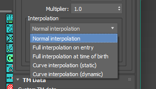

Can you add custom properties under the interpolation list as interpolation channels? This makes it easier to control the linking of two properties, like this
(10-15-2024, 08:28 PM)Xiaoshushu Wrote: Can you add custom properties under the interpolation list as interpolation channels? This makes it easier to control the linking of two properties, like this

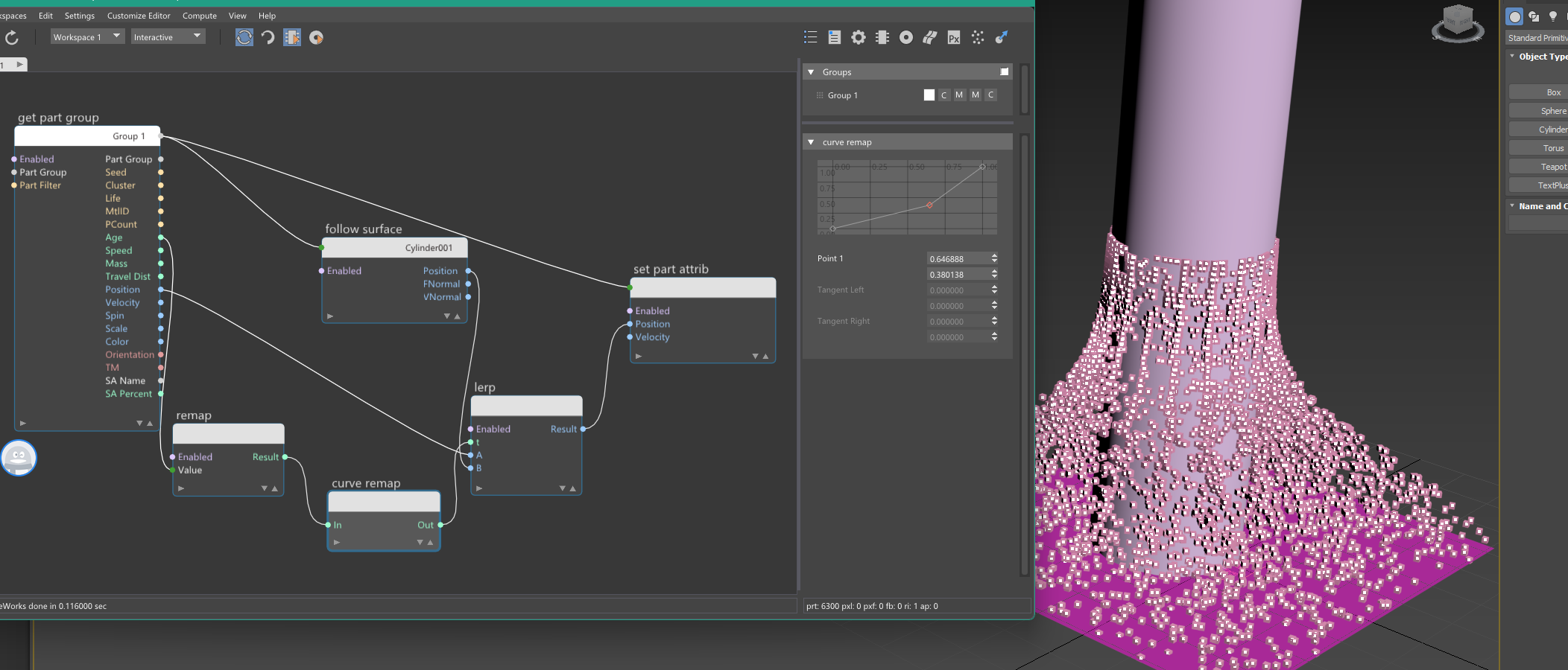

Hey, what program is the left screenshot done in? Is that softimage? Max? If max, what is that plugin called to do nodal operations like that?
Looks like Thinking Particles to me
This is "fumefx_NodeWorks", a particle tool that only appears in the newer version of ffx. Its working method is similar to that of thinking particles, but its functionality is more abundant than that of thinking particles so far.
