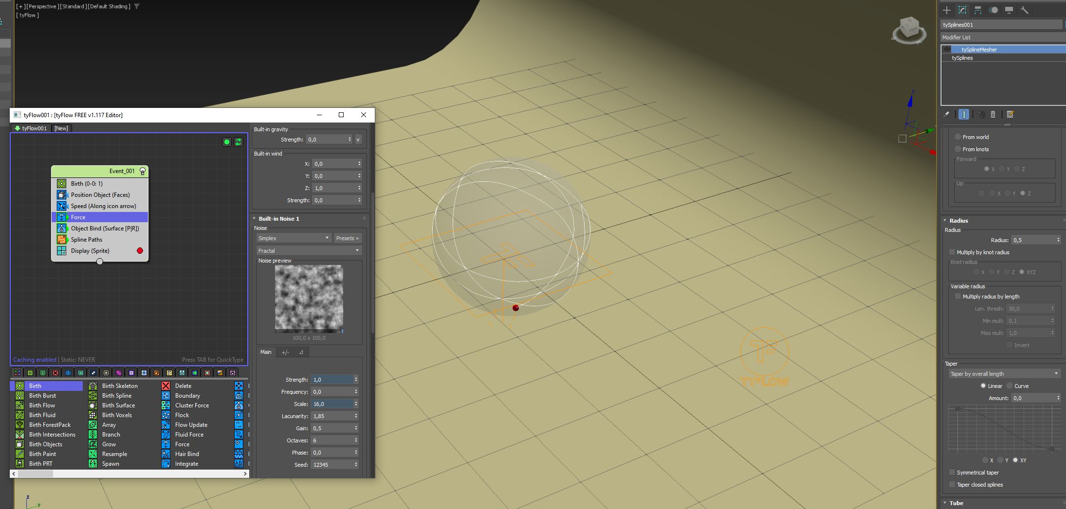

Hello everybody.
How do I save a tySpline as an editable spline?
I would like to use the spline together with Path Deform, so I can make a chain wrap around an object.
Just cant figure out how to convert the tySpline to an editable spline? Smile
Thank you.
I figured it out. Maybe?
Made the spline an editable poly. Choose and looped an edge and detached as object.
