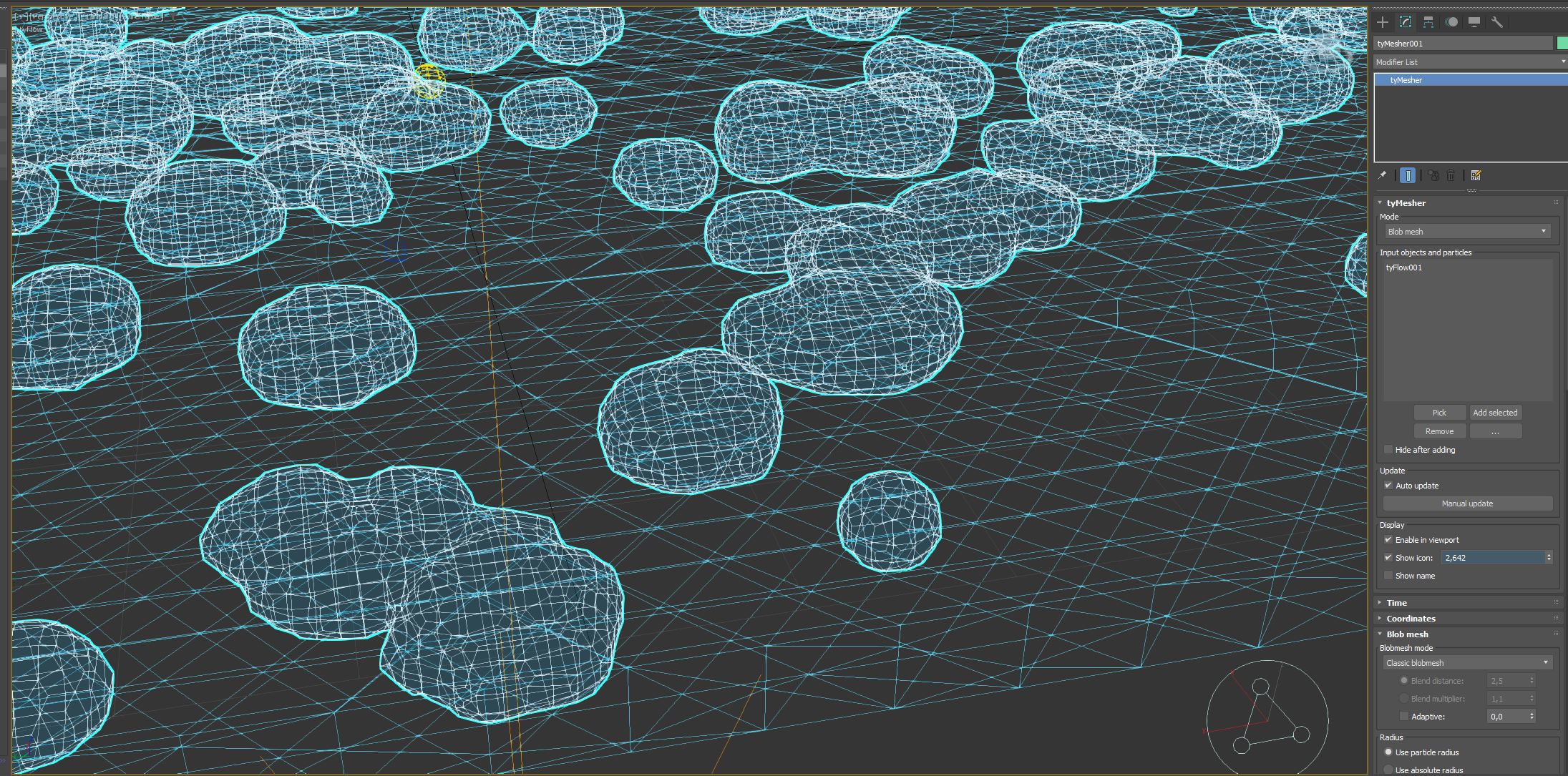

I first switched to production rendering mode (from active shade), and I gave it default physical material.
Then, of course mesh operator I switched to triangle, render off... and whatever modifier I added, it just ignored modifiers (both turbo smooth and mesh smooth, I even tried adding edit mesh bellow meshsmooth), and it just rendered raw particles (it ignored modifiers)
I haven't rendered in Arnold in years... so I might miss something in it's options.
However it works if I use Tymesher in combined mesh mode, and hide TyFlow.

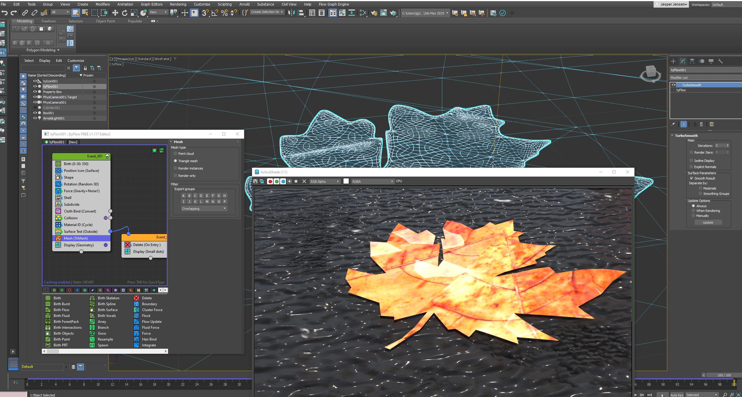

#10

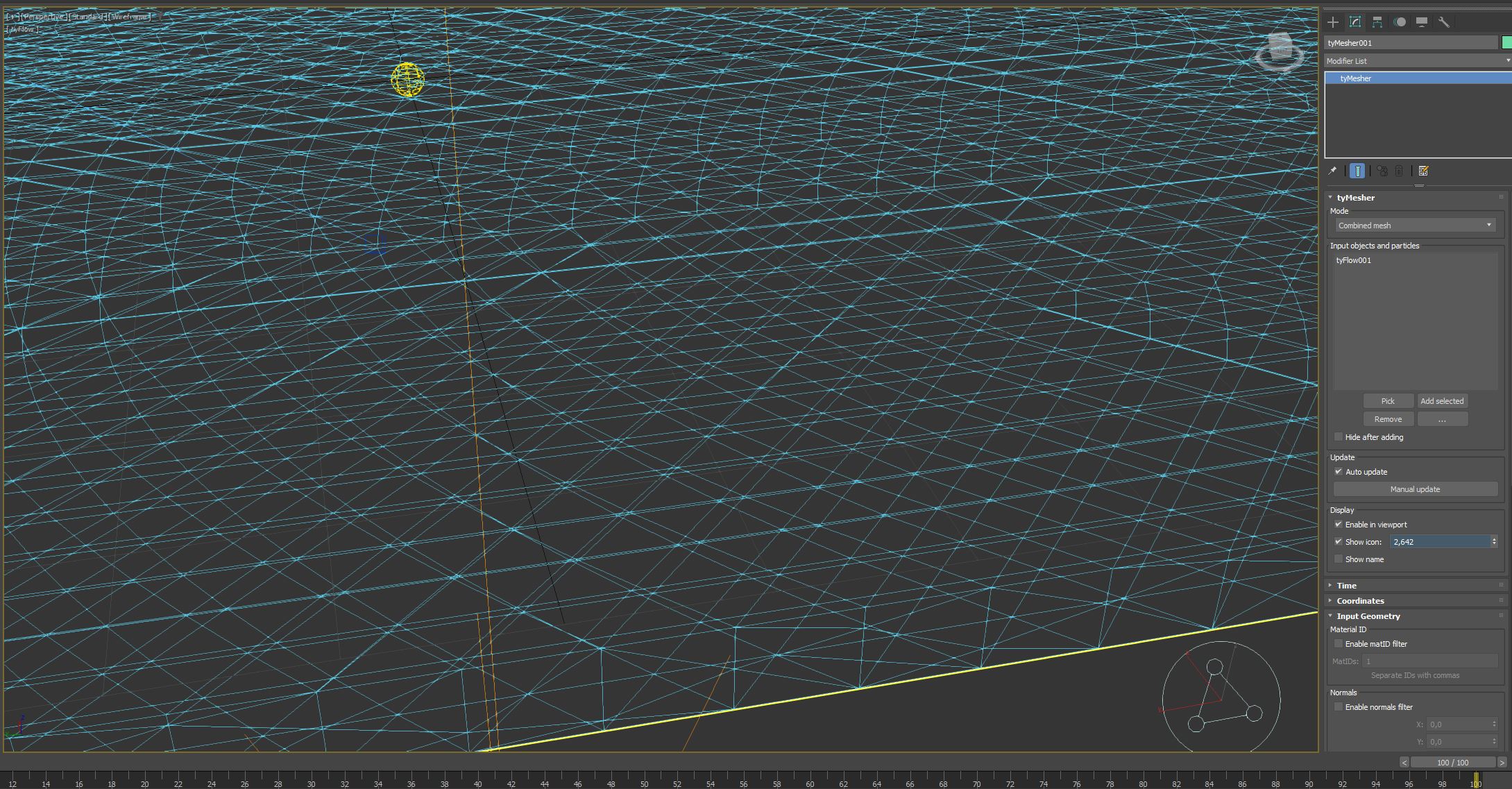

Ps. When I use tyMesher combined mesh, like in your screenshot, the particles dissapear.

Combined mesh makes particles dissapear for me.

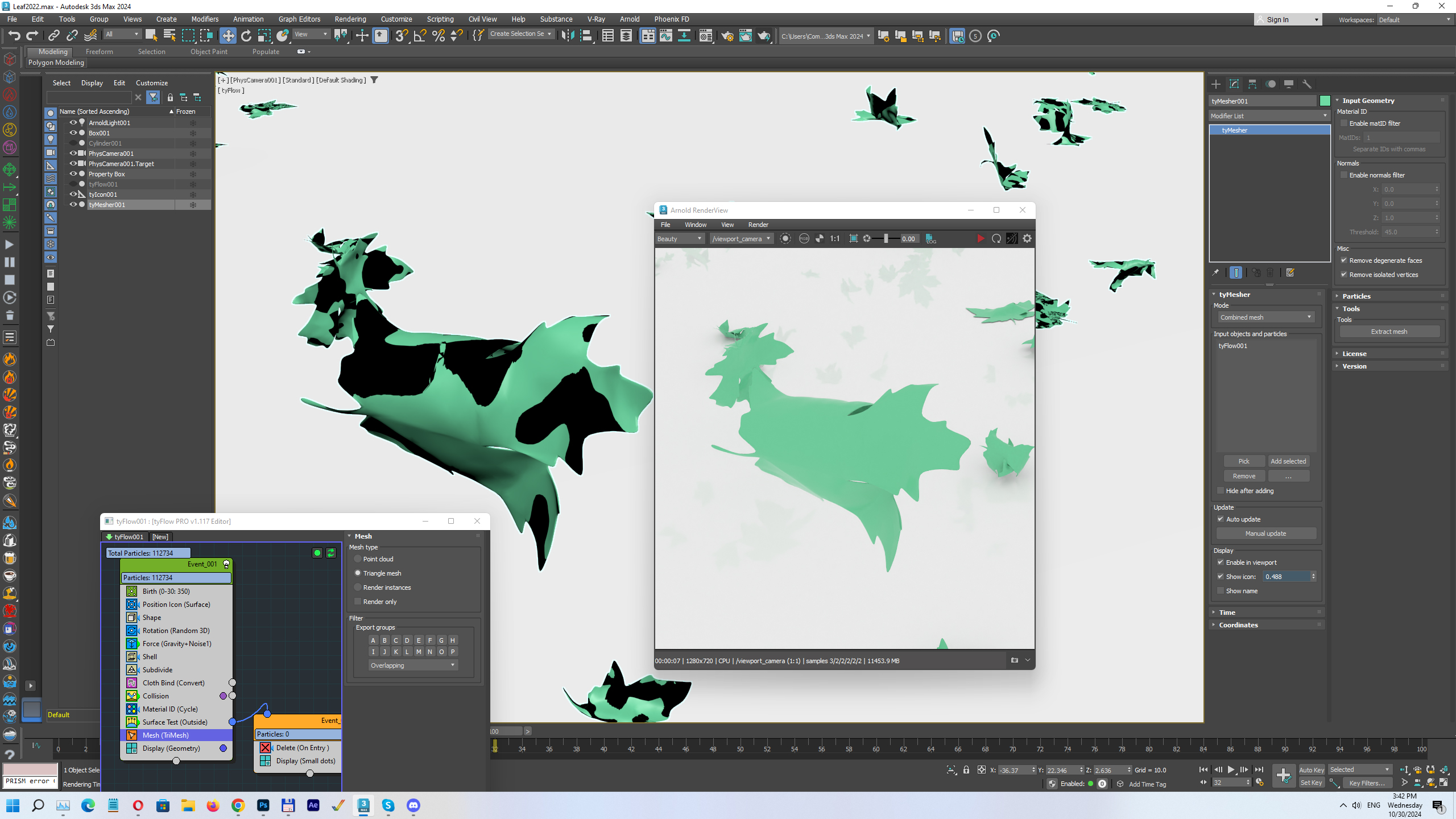

Oh, it's cloth...I missed that.
When using tyMesher you'll need to turn the particle interface off in the tyMesher settings or else it won't generate the mesh (because the particles have no mesh and a cloth mesh isn't a particle).

(11-01-2024, 01:14 PM)tyFlow Wrote: Oh, it's cloth...I missed that.
aah, that works.
Thank you  Heart
