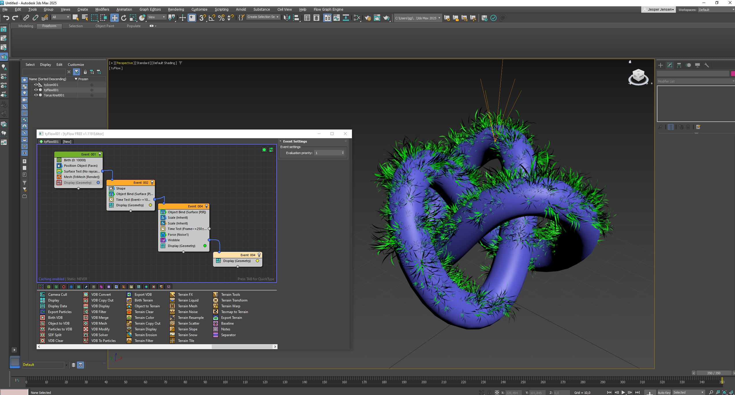

I made a torus knot with growing grass and would like to add movement (Wobble) to the grass.
But I cant really figure out when/where to use Wobble?
Some help would be appreciated Smile

It's possible.
You need to set force in your last event... I also tweaked wobble settings (so they are not so stiff), and I switched display to dots so you can actually see what is the distance of wobble.
Check attachment.

(12-02-2024, 01:40 PM)d4rk3lf Wrote: It's possible.
Check attachment.
Aaah.
I see that makes all the difference.
Looks very cool.
Thank you d4rk3lf
