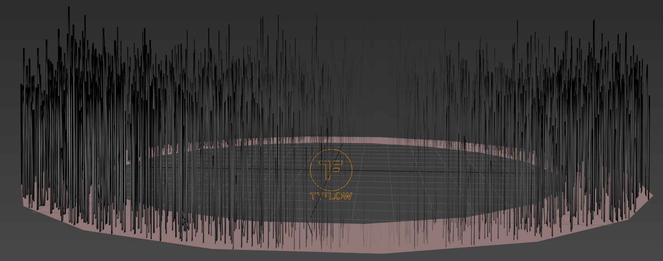

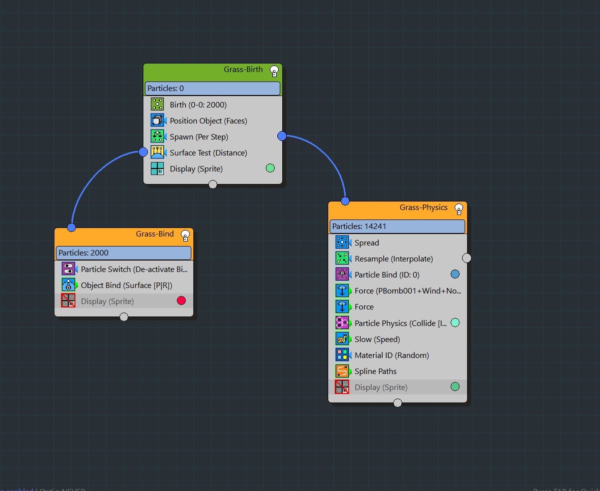

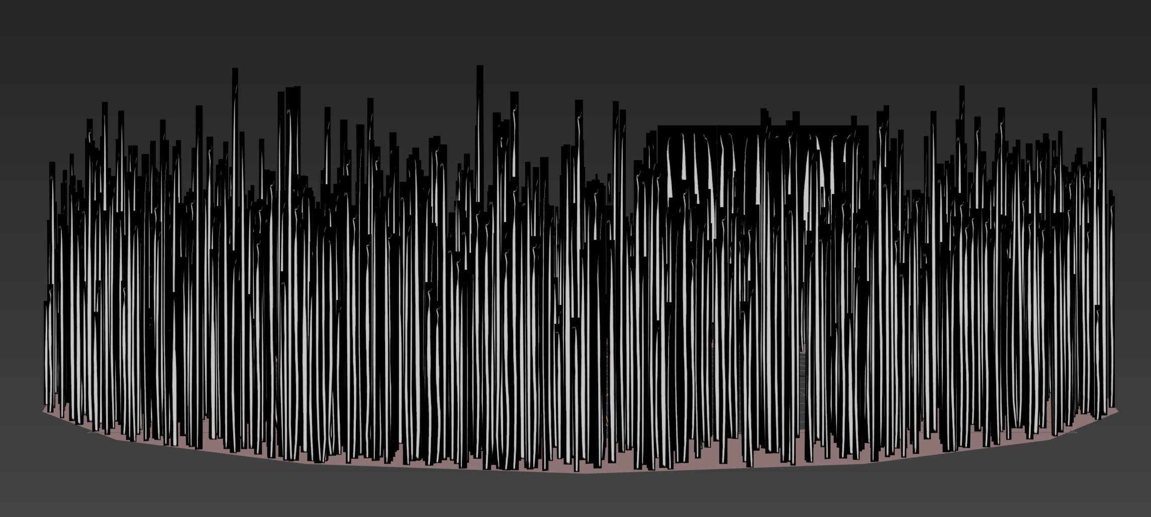

I have some simulated grass that works great, using Spline Paths operator in mesh mode i added 16 blades of grass on flat planes, however, they all face the same direction. Nothing i do in tyflow with on the particle side seems to change their direction. Also nothing seems to work on the spline mesher either, there is a rotation but no option for random.
Examples below
Use a Rotation operator in your flow to set the particle orientation, then choose "from knots" as the orientation mode in the tySplineMesher.
(12-18-2024, 02:14 AM)tyFlow Wrote: Use a Rotation operator in your flow to set the particle orientation, then choose "from knots" as the orientation mode in the tySplineMesher.
Perfect, thanks so much!
