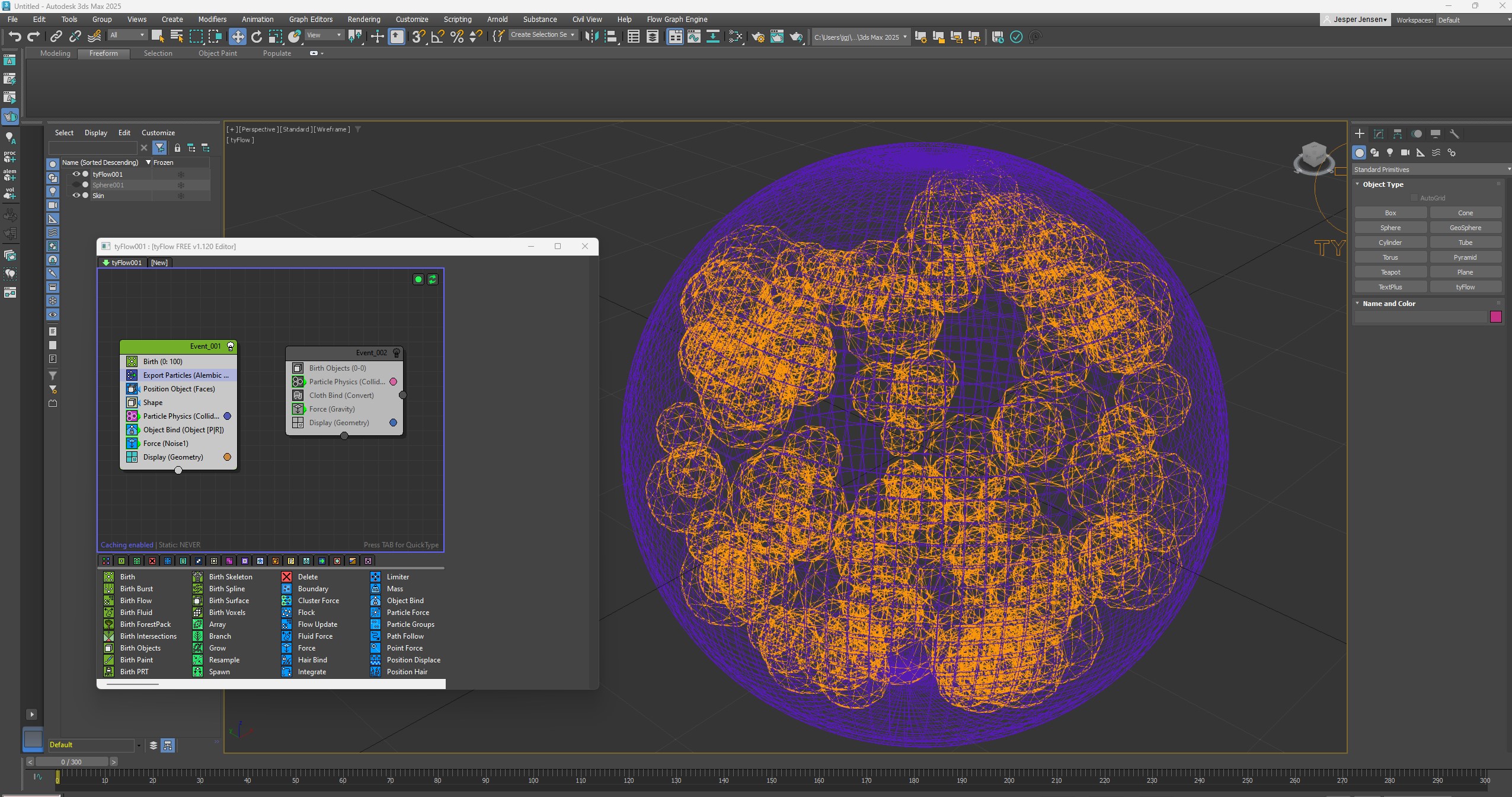

I have been trying to make a "sack" with moving balls in it, but with limited luck.
How should I make that?
Using tyParticle skin looked bad. Just tore the round "sack"
Basically I am trying to to make an animation where you can see the sack contains moving balls.
Imagine a bag of marbles, with the marbles moving around.

I did a quick test, and here is how it turned out.
I guess, you could also use PhysX (especially if objects are not spheres)
.mp4   Marbles_in_Bag_Perspective_preview_v001.mp4 (Size: 3.29 MB / Downloads: 311)
.max   Marbles_in_Bag.max (Size: 832 KB / Downloads: 297)
